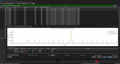

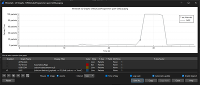

I implement Open Bootloader middleware to communicate USART protocol over USB CDC on Mbed OS 6
I found when I open STM32CubeProgrammer and click Erasing & Programming tab first time, program will freeze. But after first time does not freeze.
After Click Erasing & Programming tab. Program send Get ID for 100 packets per sec
Graph with 1 Sec interval, Get ID packets (I only filter 0x02)
Graph with 100ms interval, Get ID packets

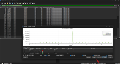

Before Click, 2 Get ID per 1 sec
After Click, 513 Get ID packets with no delay

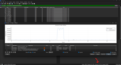

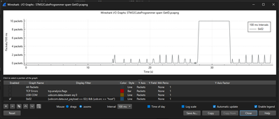

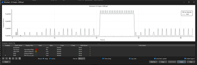

I also try with FTDI and result is mostly same
Graph with 100ms interval, Get ID packets 6-7 packet per 100ms
And also 513 packets

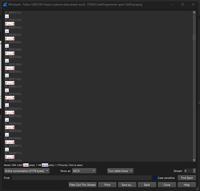

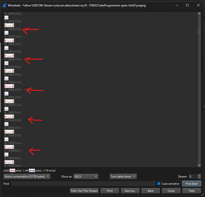

I also found when before and after buck send. Program change baud rate to 9600 and switch back to 115200 (I use 115200)

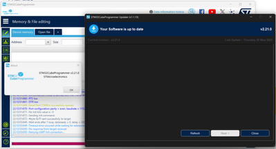

Hello @Maryem
Thank you for update in version 2.21.0 This problem has been fixed with '212409 [GUI][UART] Excessive 'Get ID' packets causing GUI freeze in STM32CubeProgrammer'

I don't know how to decode USB package. So, I filter using `f2:0c:fe:6f:ff:1f:01:00:00:00:00:00:00:00:00:00` This look like send every 1 sec. And behavior look like UART have 513 packets after click Erasing & Programming tab

Hello @Maryem
