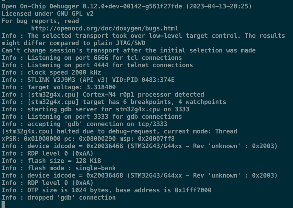

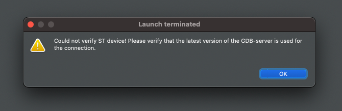

Hi! I am trying to establish workflow where team can connect to one remote board to develop and debug it with STCube IDE. Currently I'm using Raspberry Pi 4b as a server. The thing is, when I connect Nucleo directly to my laptop - everything works fine but when connecting over remote I get could not verify St device. Anyone has any idea how to fix this? Attaching openocd config and error message screenshot. I've tried building openocd from ST repository and openocd repo, master and release versions, also tried to build gdb server 13 from sources for both raspberry and arm toolchain for Mac and setup accordingly in STCube IDE.

Did you find solution to your problem? I'm facing the same issue with latest STM32CubeIDE
dnssoft
I am also facing this issue.
Has any version of STM32CubeIDE worked properly?
Neolithic
I am having an exact same issue with latest STM CUBE IDE. Did anyone find the solution to the problem?
