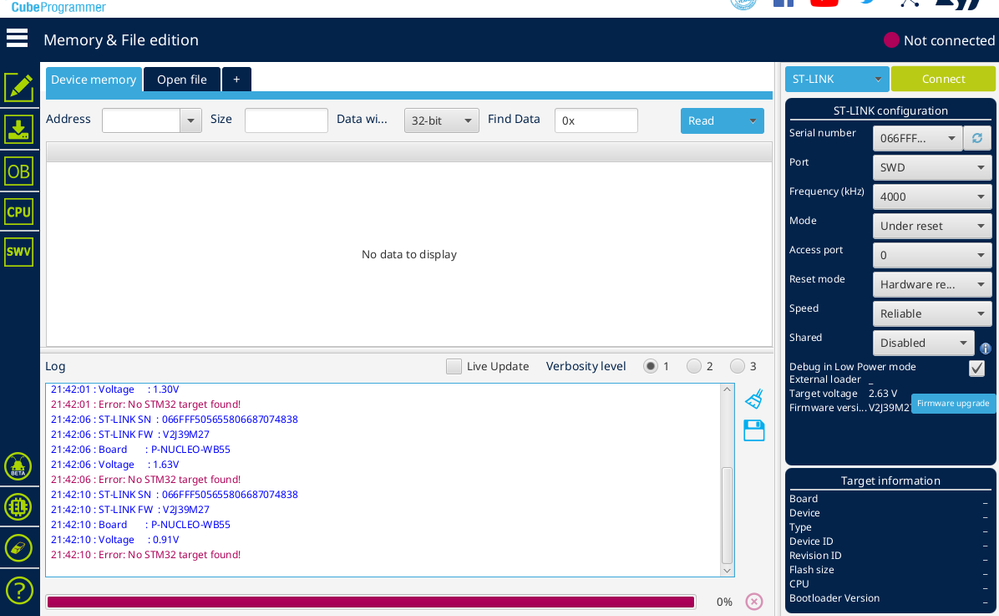

STM32WB55RG Error in initializing ST-LINK device. Reason: No device found on target
LZure

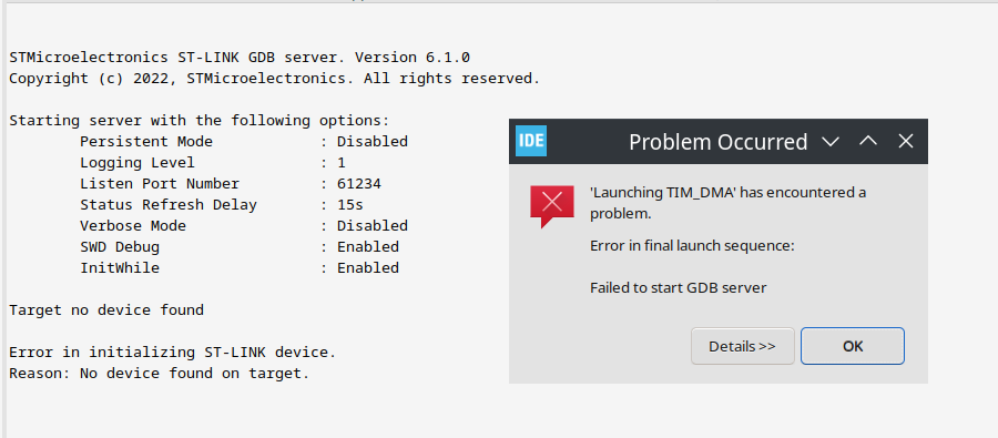

I have two P-Nucleo-WB boards and both of them end up in this state.
CubeIDE trying to load binary:

Configure connect mode to Under reset
LZure
I have tried to connect it "Under reset mode" with pressed reset button. Result is the same:
MM..1
Chief III
Seems power on your board is unstable. Check it ... Under reset is mode not presed but
LZure
Power comes from USB port and it's the same on other ports. Connecting under reset results in this same error. Is there any other method I could try to bring back my stm?

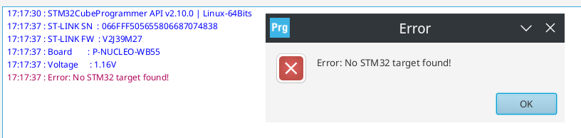

LZure
I have managed to run board in bootloader mode and successfully connect with CubeProgrammer through UART. I was able to load bin file. Unfortunately ST-link still does not work and I receive all the time this same error: "No device found". Any thoughts what else I can do?

I have checked voltage on my both boards and it seems like both of them got this same issue with voltage:
First board:
5V pin measured 2.5 V and 3V3 pin measured 2.3 V
Second board:
5V pin measured 5 V and 3V3 pin measured ~0 V
Strange is that I have taken precautions after first board failed and only think I did with board was plug/unplug st-link usb cable.

Jumpers are ok. I had right voltage before. It seems like I have bricked somehow two this same boards with my program. With first I had doubts if I have break it with some static charge but with second I was rather cautious doing stuff and yet, it still got broken. Do you think it is recoverable?
Best regards
