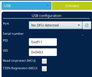

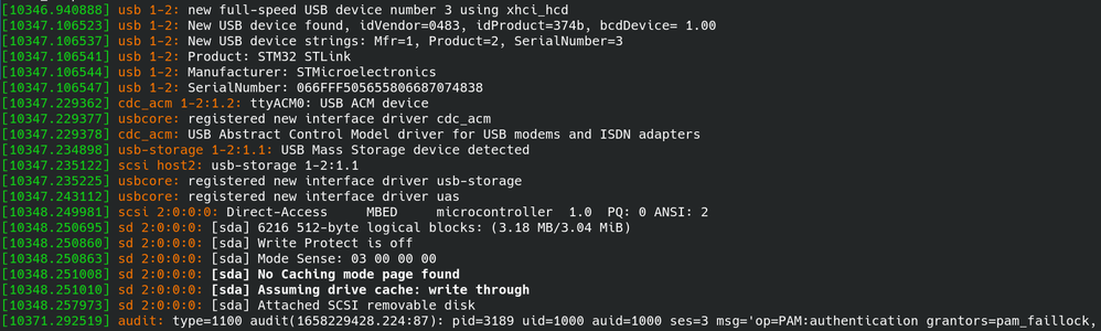

LZure
This is how my Linux recognize device:
0693W00000QLW33QAH.pngJumpers are set up as you described. I can't connect by DFU:

LZure
Hi Remy,
I was able to connect with USB DFU mode however I don't know how to recover option bytes. Could you please tell me how to do that?
