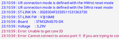

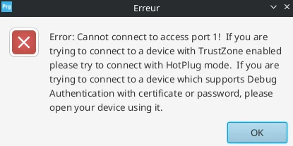

Using STM32CubeProgrammer, I get this error on Access Port 1 with Hot Plug mode:
But I've not configured anything: I've not blown any OTP fuse, nor changed any Option bytes. And I'm not using a secure bootloader, I have just the generated FSBL from STM32CubeMX which loads the application from flash to RAM using ExtMemManager.
I'm assuming the DEV_MODE is doing something to open the debug access before doing it's busy loop waiting for a debugger to attach.

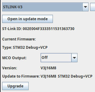

Hello @AMurz.1 ,
Please try upgrade the ST-link firmware and use latest release of STM32CubeProgrammer.

Thanks for your reply.

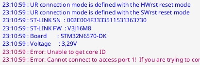

I have tried with the latest versions of STM32CubeProgrammer and ST-Link firmware, but the error is the same:
- ST-Link Firmware version V3J16M8
- STM32CubeProgrammer v2.20.0
When trying to access the STM32N657 using STM32CubeProgrammer while having booted from FLASH, I get the same error:
This is the STM32CubeProgrammer logs:

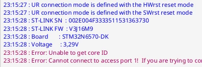

I've also tried with the latest ST-Link firmware V3J16M9 from https://www.st.com/en/development-tools/stsw-link007.html, but this gives the same error:
All of these errors appears only when booting from FLASH instead of DEV_MODE, I'm using FLASH mode as I'm trying to attach the debugger to an already flashed program.

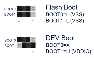

I'm using BOOT0 and BOOT1 to choose the boot mode between Flash mode and DEV mode; I'm following this article: STM32N6 boot ROM explained:
I'm trying to attach the debugger on the STM32N6570-DK board while it is booting in "Flash Boot".
Using "DEV Boot" with BOOT0=L and BOOT1=H, I can attach both the debugger and STM32CubeProgramer to the STM32N6. This is the documented way to debug the STM32N6 for development purpose (How to debug STM32N6 using STM32CubeIDE).
But here I'm trying to attach the debugger on the STM32N6570-DK board while it is booting in "Flash Boot" (BOOT0=L and BOOT1=L). This is where I get the errors I wrote in my previous posts with both ST-Link GDB Server (Target unknown error 32) or STM32CubeProgramer (Error: Cannot connect to access port 1!).
