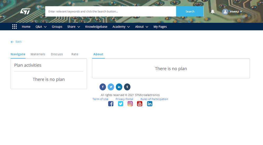

Hi @Imen DAHMEN​
When click on "Access the Course" I don't see any material in it, below is screen shot. I have log-in credentials registered on STM.
 0693W00000BdYegQAF.pngIs there anything I am missing here ??
Inside the firmware file check for projects and then choose the folder with stm32wb5mm-dk written. In this file there are two examples related to mesh.. Just try to do right provisioning once the code has been flashed .
