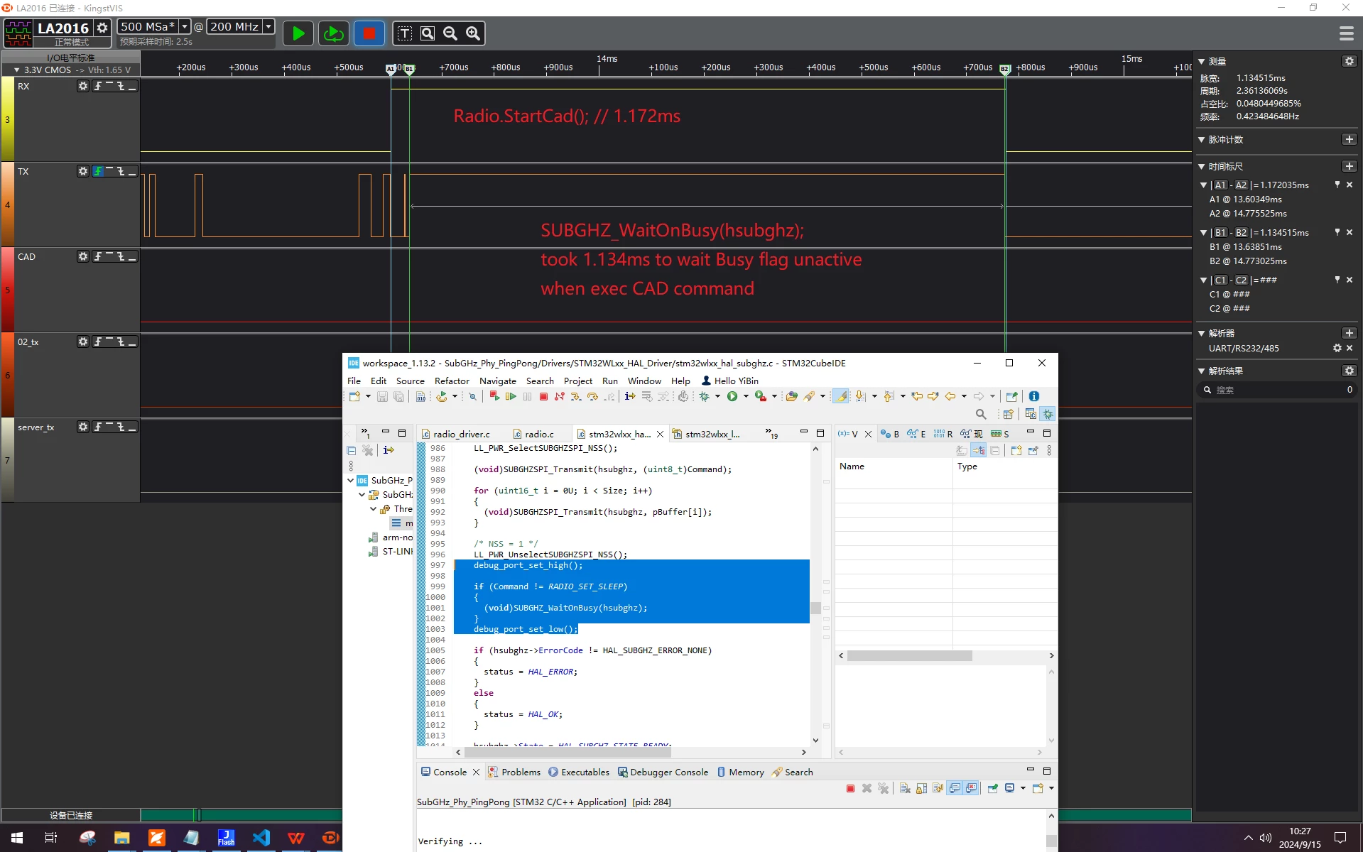

hi, I have developed applications using STM32WL base on NUCLEO-WL55JC1.
But I found when enter CAD there is a long time block on SUBGHZ_WaitOnBusy(). About 1.2ms.it’s so long than I thought

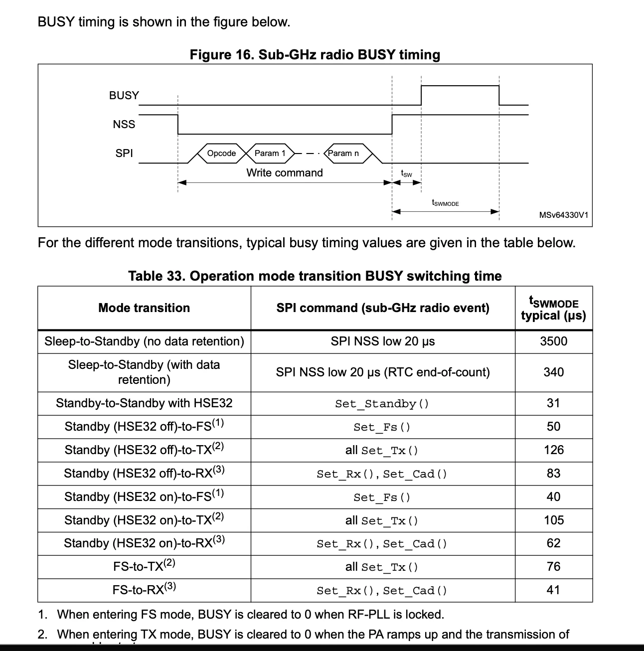

Hello @Yibin and welcome to the ST Community.
on the NUCLEO, there is a TCXO. The TCXO requires a wake-up time.
in the cubeWL_1.3.0, the TCXO_WAKE_UP_TIME is set at 1ms, probably this is what you see.
To change this, you can go in SubGHz_Phy/target/radio_conf.h
/* Radio maximum wakeup time (in ms) */
#define RF_WAKEUP_TIME 1U
This can be lowered to 1ms without impacting the RF performances.
Depending on your RF requirements', you may want to use the XO instead of the TCXO. By, using XO, there is no wakeup time anymore (at least XO settling time is barely noticeable)

The code is like this:
Radio.StandBy();
Radio.StartCad(); // toke 1.172ms to exec, most of time (1.134ms)is wait for busy.
