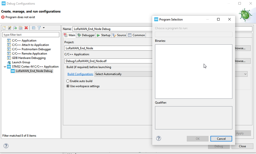

I had one STM32 debugger (ST-LINK-v2). how to learn the STM32 debugger and how to connect the stm32 chip to the debugger. give any solution or tutorial.

What happens when you do Project:Clean... selecting your project but also turning OFF "Start a build immediately"?
Once that's done, right-click on the project in the Project Explorer (IDE icon) and do "Build Project".
There might be warnings/errors that either step throws up. Please report back listing those errors
I'm not sure, but I have faced this problem quite often. Please provide any other suggestions to fix this issue.
This time too, an error occurred while creating an elf file. What should will I use to minimize this problem? kindly tell me.
@Danish​
What was the precise error message? These messages are meant to contain clues ss to what the system was trying to do that failed which can lead to what’s wrong and how to fix it.
If it was (for example) “an error occurred while creating an elf file�? then please show a screenshot of how that message is presented and the sequence leading up to it.
I faced the elf file errors again. what I do to fix this problem.
I successfully created an elf file when starting a new project. But occasionally when I ran the debugger, an elf file problem occurred. Please provide a solution to this issue.
kindly help me
@Danish​
I'm not interested in the absence of a created file when build fails to complete.
What would be helpful is any messages that appear in any of the windows in response to your request to build the project when you right-click on the project (IDE icon) in the Project Explorer and do "Build Project"
Without that, I can't help you.
thank you for your guidance @Danish​
I solved the elf file error with your guidance.
