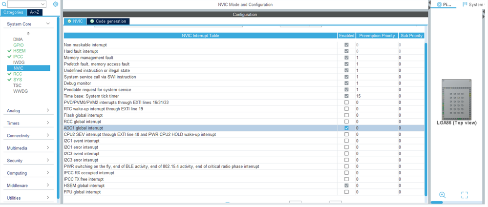

0693W00000QLrzwQAD.pngHi,
I am using Zegbee messaging cluster on STM32WB55 to send messages between some Zigbee end devices and a coordinator.
Each end device measures the temperature via I2C sensor and sends a message with the temperature value to the coordinator and then goes to sleep mode for 5 seconds. The software works well.
But when I try to also measure the reference voltage to send its value with the temperature value in the message, the software freezes!

When i comment the block form HAL_ADC_Start( &hadc1); to HAL_ADC_Stop(&hadc1); the software works fine.
Also when i put this block in main.c in While(1) loop bevore the command UTIL_SEQ_Run(UTIL_SEQ_DEFAULT); the software works also fine.
So, it appears to me that, the problem accrue when trying to run the adc within a task in the sequencer. If that is true, How to solve this problem?
Below are the code of ADC1 and System Clock Configuration, also a foto of the the NVIC Interrupt Table.

1 REPLY 1
Remy ISSALYS
Can you give more information about the task registration for ADC measurement and when you are setting the task ?
