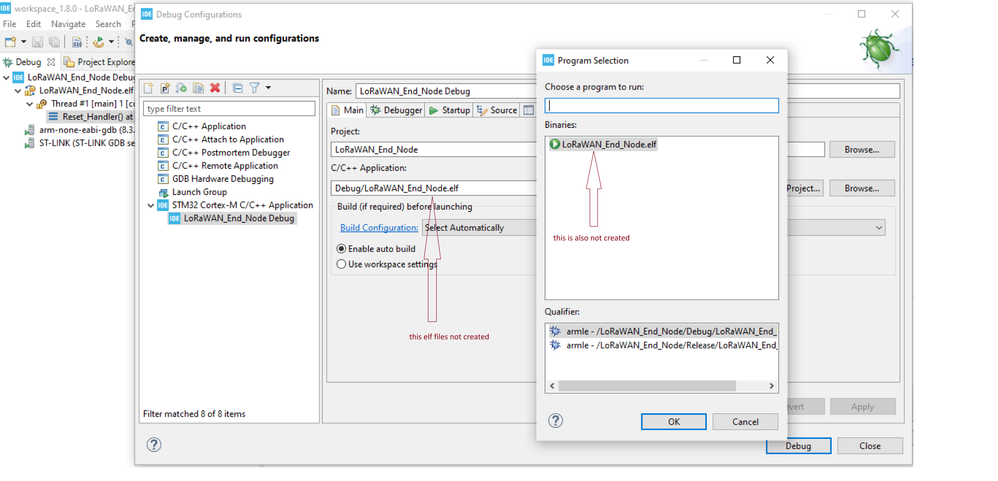

@Danish​ I debug the normal interrupt and took the value on the live expression. but the problem was faced it the elf file error. so I re-install the cube ide software and run it. this elf file was generated. what problem occurs, why was the elf file not generated. do you have any other alternate method?
‎2022-07-18 1:11 AM
Can you post a screenshot including some of the error messages you get. Maybe they don't translate very well to/from English.
And the result when you build your project.
When you build your project, STM32 Cube IDE should generate an ELF file unless either:
- there's a problem with the source-code
- or The IDE doesn't know how to build the code (e.g. "external builder" is selected rather than "internal builder")
- or the build set-up somehow requests not to generate an elf file.

Some time did not create the elf file on stm32 cube ide. why this file was not created kindly explain. I attached that image above.
‎2022-07-19 12:26 AM
Learn capturing screenshots normally so that those are not resized to ridiculous 11472x5528 pixels. Screenshots should not be resized at all!
