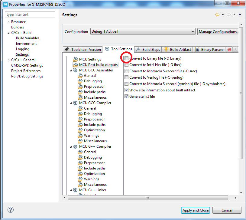

No it's not a bug. It's normal. You shouldn't use the .bin file.
The only interesting files are .elf file and .hex file to download you project into your board.
You can remove the generation of the .bin file by unchecking the option in the project settings.
/Alexandre

You have to debug the *.elf, not the *.bin... There´s also the possibility to switch off the building of the *.bin files, if they´re not needed. (can´t take a closer look, where exactly to do so :( my laptop is not within reach right now... It was somewhere in Properties, c/c++ build...)
For now it should work to go to your debug configuration and choose the correct file (the *.elf) :)
