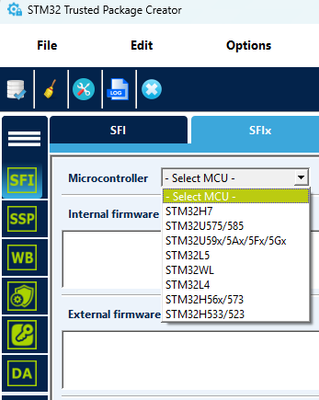

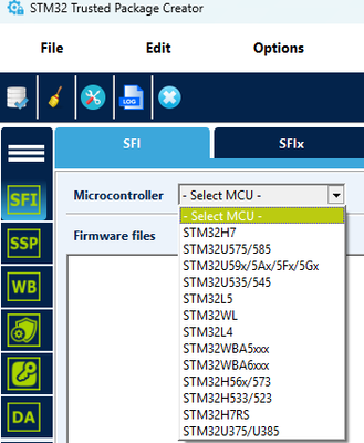

P.S. I have also considered trying to use the GUI for TrustedPackageCreator and manually creating a signed and encrypted binary. However, the dropdown list of MCUs for both SFI/SFIx do not show the STM32N6 part.

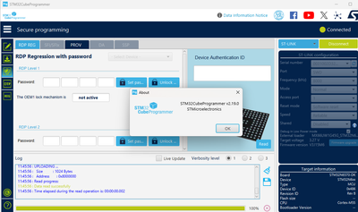

Based on this forum post I also tried to look in STM32CubeProgrammer. However, the SFI/SFIx tab is grayed out, even if connected to the on-board ST-Link.
I have confirmed I am using the latest version of STM32CubeProgrammer by checking that the Release Note on the download page on ST's website is showing v2.19.0.
