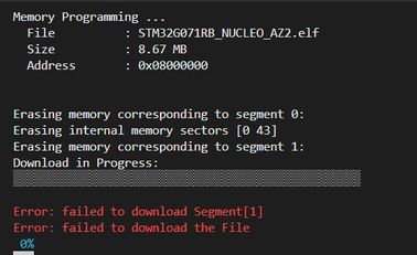

Hello.
I've been struggling to flash a simple TouchGFX application through the STM32 VS Code extension. I am using the Nucleo-G071RB dev board with the GFX01M2 display board. My project was initially created using the TouchGFX designer, then generated the CMake project in CubeMX. In VS Code, I added the SPI_FLASH section in  STM32G071RBTX_FLASH linker file, and the cmake/touchgfx sub directory in the CMakeLists. This allowed me to build the project with no errors. However, whenever I try to flash, I get the following:
I suspect this has something the do with the external flash. I am aware of an external loader file that you have to select in STM32CubeIDE, but I'm not too sure what would be the equivalent in VS Code.

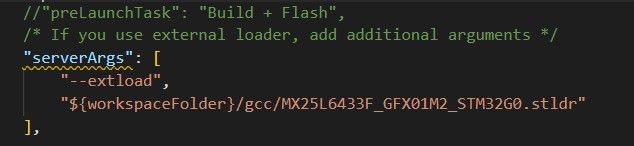

Hello @GaetanGodart,
Thank you for your reply. It seems like the flash issue happens right from the get-go. Without the SPI_FLASH, I get a flash overflow on the internal flash. And without the cmake/touchgfx in the CMakeLists, I get compile errors. Regarding the launch.json, I uncommented the external loader section:
This had no effect. I'm not sure if the external loader is being used or not.

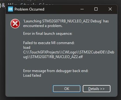

Regarding STM32CubeIDE, the code works fine using ST-Link GDB server and the external loader generated by touchGFX. However, not including the external loader, I get the following error:

Hello @TS-LMG ,
The STM32GG071RB doesn't have a lot of internal memory.
If in TouchGFX Designer you open a demo compatible with the STM32G071RB, you will see that we put everything in external memory to not have an internal memory overflow like you do.
Regarding the STM32CubeIDE issue, it could be because you are missing the external loader in the configuration of the software. You can add it like that :
right click on your project => Properties => Run/Debug settings => External loaders
The OpenOCD issue seems to be the same : not able to load to external memory.
