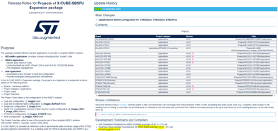

Hello @lavanya ,
Which STM32CubeIDE version and MDK-ARM version are you using?
It is mentioned in the release note projects of X-CUBE-SBSFU Expansion package that the development toolchain and compiler used for this package is STM32CubeIDE v1.9.0 and MDK-ARM V5.31.
 For that please try to update the STM32CubeIDE toolchain.
Also, possible build issues may be caused by too long path names. I suggest you to unzip the package in a short path like e.g. C:\work.
May this discussion can help you.
Please let me know if the issue is solved or not.
I hope this help you!
Kaouthar
