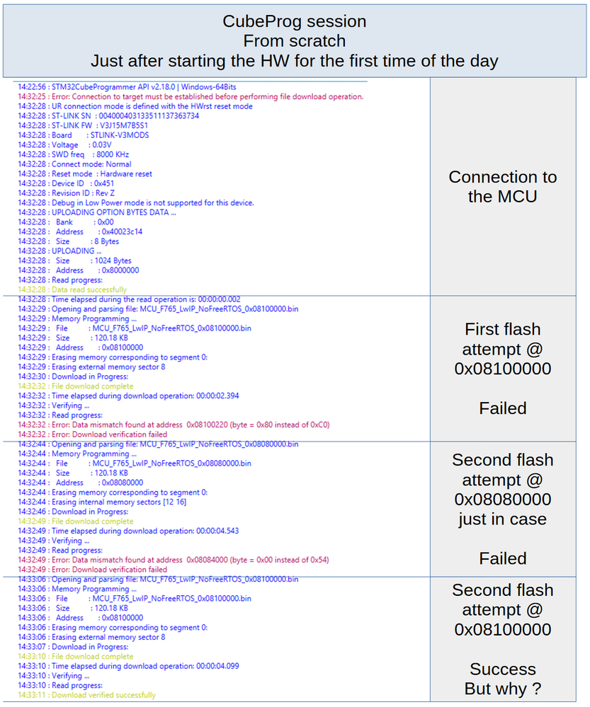

  • if I found and read the proper documents, an F765 as 1 MB of flash. It is confirmed by CubeProg when connected. According to AN4826, bank 1 starts at 0x08000000 and bank 2 at 0x08080000. This seems wrong, because I can’t flash at 0x08080000. Instead, my 2nd FW can be flashed, and runs (sometimes), at 0x08100000 (512 kB further). But this address should be correct only for the F769 and its 2 MB flash, not the F765 and its 1 MB flash. What’s going on ?
  • by the way, when flashing bank 2 with CubeProg, sometimes, I get a verify error. I could not understand why, nor be sure how to successfully, or fail to, flash bank 2 again (disconnect/reconnect ? Reset ? Power cycle ?)

[DAY 2 - 1/2 : the struggles with CubeProg]
Apart from the confirmation/invalidation of the bank 2 start address I'm using, here is today's first flash session :
