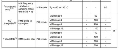

IP clock source selected is not compliant with 400ppm. Since, the source for PLL1P clocked with MSIS.
According to the datasheet, MSI output characteristics are stated as follows.
According to the reference manual, section 11.4.19 OTG_HS clock, MSI is not suitable for this USB OTG HS use case.
I hope this helps!

  1. There is an issue linked to description of register interface in SVD file related to stm32u5a9xx.h USB_OTG mess · Issue #31 · STMicroelectronics/STM32CubeU5 (github.com)An internal ticket 170738 is submitted for an update.
  2. In USB standards, input clk of USB should be 500ppm compliant. I'm afraid to tell you the answer is no.
