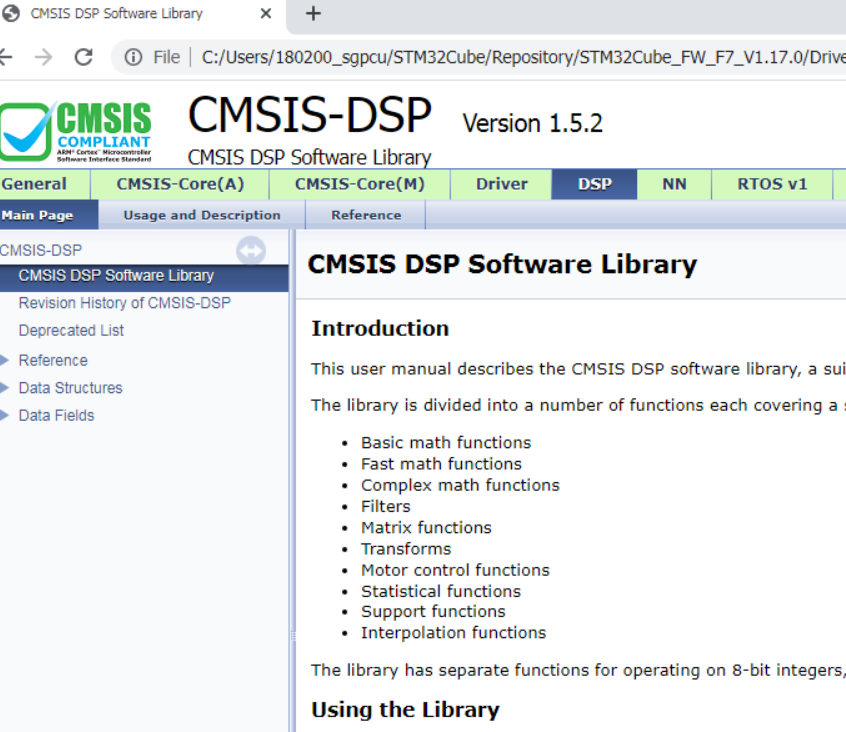

Did you able to figure out how to use quaternion math functions from DSP library. I downloaded latest CubeMx and the version of the DSP is 1.5.2 as shown below
0693W00000WJlo4QAD.pngIt misses lot of functionalities like matrix vector operations.
Thanks in advance.
