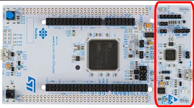

Andrew Neil
@b.a. wrote:
I have a Nucleo-L4R5
You mean the Nucleo-L4R5ZI ?
@b.a. wrote:
 for power consumption reasons, deactivate the ST-Link.
That board has the break-off ST-Link section (highlighted above). The surest way to deactivate the ST-Link is to break it off!
Yes, that's the board I use.
Of course I am aware that the ST-Link can be broken off.
So if I am asking here, maybe that is not the solution I would prefer...
Furthermore, I really would like to understand what is going on.
I am quite sure that breaking of the ST-Link will not change the current behaviour of the board not running the program with deactivated ST-Link.
So I'll end up with a broken board AND no solution ...

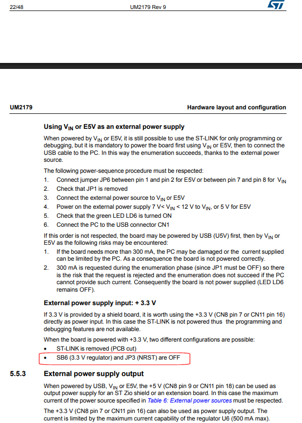

@b.a. wrote:
ST-Link is holding the NRST line down.
nailed it :)
Glad that helped!
The User Manual mentions it for external 3.3V operation, but not 5V:
https://www.st.com/resource/en/user_manual/um2179-stm32-nucleo144-boards-mb1312-stmicroelectronics.pdf#page=23
@STTwo-32 - is this a documentation error/omission?
