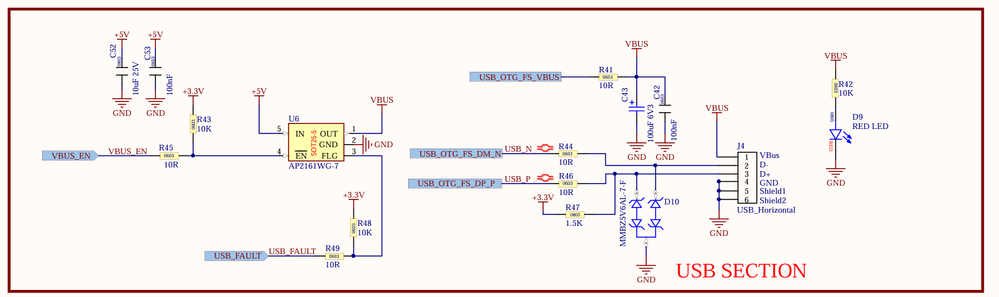

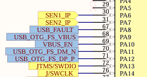

Schematic diagram of USB section & Pinout :

The host controller of STM32H750 is at most capable of High speed, it cannot work in super-speed mode.
Please inspect the descriptors of this USB drive. Maybe it has multiple configurations and the High speed is not the 1st one. If the drive has a configuration for USB 2.x compatible mode, select this configuration.
Quick check:  connect this USB drive to a Windows PC via USB 2.0 hub (not 3.x!) and see if it is detected.

Since the MCU hardware and USB Host controller do not support USB3.x super speed, the detection relies on the device falling back to USB 2.0 mode. If it fails the quick test, then device is non compliant and it violates USB protocol specifications.
So, you may inspect USB Descriptors: Use tools like USB Device Viewer (Windows) or lsusb -v (Linux) to check the configurations and interfaces descriptors.
