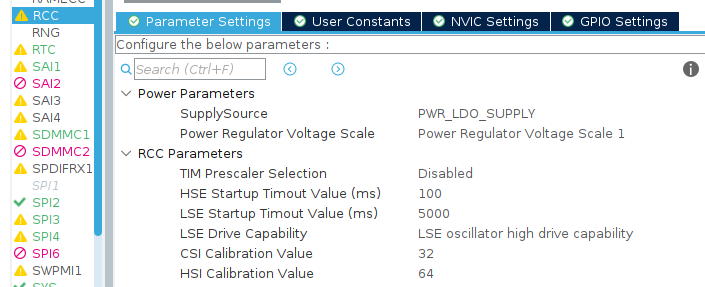

> Does anyone experience the same?
yes.
  1. for rtc working, set LSE drive high level .
  2. if start after short power off not good, try : solder par. to VCAP (2uF...10uF) 470 ohm.

Hi @RKrec.2​
Could you refer to AN2867 Rev16? Special focus on section 3.4, make sure that Gm_crit_max (MCU) > gm_crit (crystal). Also, section 3.3 to calculate the external capacitors then fine tune.
As mentioned in RM0399 Rev 3, section 9.7.25, before writing into RCC_BDCR.LSEDRV to change the drive level. The BDCR write protection should be disabled.
