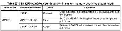

For reference, according to the application notes, the following must be set for USART1 communication with the bootloader:
For all the configurations, my logic analyzer was set to 115200 bits per second, 8 bits per transfer, 1 stop bit, even parity bit.
If I can read a response using configuration 4, shouldn't that mean that commands are correctly being sent from MCU 1, commands are being correctly read by MCU 2, response is being correctly sent from MCU 2, but the response is sometimes incorrectly and sometimes correctly read by MCU 1. Would anyone know how I can fix this?
