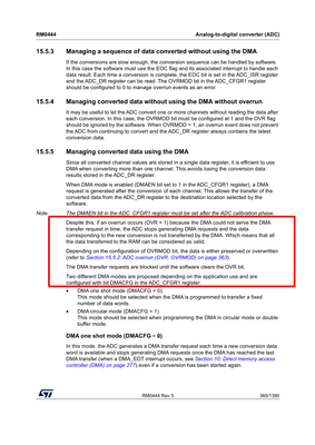

waclawek.jan
My guess is, that after DMA is finished, you leave timer to run and trigger further ADC conversions, which results in ADC overrun, and that in turn may prevent DMA to be triggered.
Verify by reading out ADC status register.
Read ADC chapter of RM of your STM32. The ADCs in various STM32 models differ quite a lot, I am not familiar with all of them.

That is a good suggestion regarding overrun.  I dont think it is the issue in my case.   I think the problem is I want the DMA to automatically restart, but they cannot be automatically restarted.  Need to enable and at least set the transfer count.
