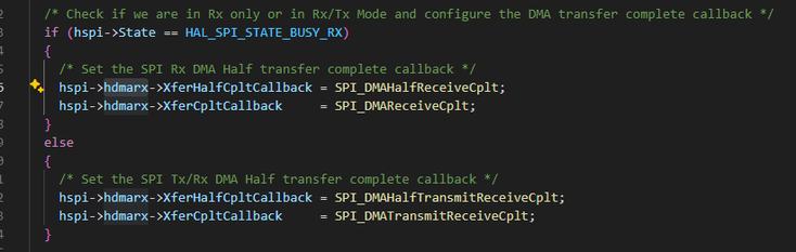

I need to start another spi transation as soon as the current dma rx transaction finishes, from whithin the "HAL_SPI_RxCpltCallback()" interrupt callback. If I do that, it fails with spi busy error, because tx dma always completes after this callback is called. I have to wait untill tx dma finishes, then I can proceed.
Based on your comment, if tx dma is neccessary, then I believe "SPI_DMAReceiveCplt()" or "SPI_DMATransmitReceiveCplt()" must be called on tx dma completion not rx dma completion. So the HAL callback assignments in below are wrong. they must be "hspi->hdmatx->...".
