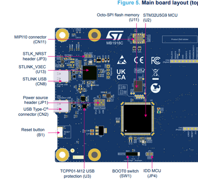

I have uploaded the schematic. If anyone can please have a look and let me know if there is some hardware problem I am missing.
Kind regards
> interrupt isn't being triggered when I connect the USB to my stm32 board
and board is ? STM32U5G9J-DK2 ?
What did you with the board ? made program...flash..?
Connect to which USB ?
CN8 is for connect/debug .
I did it to CN2
STM32U5G9J-DK2
flashed my board with stm32cubeprogrammer
