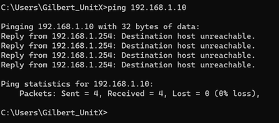

I am using a Nucleo-h743ZI2 and would like to enable Ethernet with LWiP module. I have started with the "How to create project for STM32H7 with Ethernet and LwIP stack working" guide. I am using, with a few modifications as possible, the STM32H743_Nucleo_ETH example found here: https://github.com/stm32-hotspot/STM32H7-LwIP-Examples. I can build, download and execute successfully, but cannot ping the Nucleo. When I ping I get the following:
I have included a WireShark trace. I can see some activity from the Nucleo, but am not sure if it is operating correctly. I have tried the ping from a home computer with all firewalls disabled with the same result. So, I guess I have two questions:
  1. Is the LWiP code on the Nucleo operating as expected?
  2. If so, why doesn't the Nucleo respond to the ping?

Also, using RMII.
mƎALLEm
First try the example provided natively in STM32CubeH7 under the path Projects\NUCLEO-H743ZI\Applications\LwIP\LwIP_HTTP_Server_Netconn_RTOS,
then it depends on the "few modifications" you inserted into the project.
OK, I got the example you suggested to build, download and execute. It seems it is running (see WireShark trace), but still does not respond to a ping (see attached text file showing "ipconfig", "arp -a" and "ping" commands. The WireShark trace was produced by connecting the Ethernet cable to the Nucleo.
