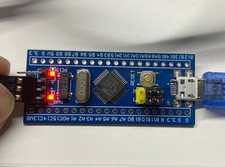

Board I am using is this. Looks like genuine STM32F103C8T6 chip.
I could upload USB_DEVICE successfully with this chip.

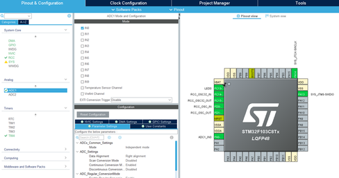

For the test, I only enabled TIM4 counter up mode with Global interrupt and ADC1 as DMA.

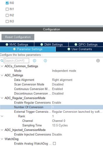

ADC channels are set as below.
I made a git repository here for review.
https://github.com/kyuhyong/stm32_adc_test
TIM4 on this project is not working when only 1 or 2 channels are enabled. (Only 1 ISR is called then stop)
If I enable ADC1 with more than 3 channels, TIM4 works as expected. (checkout to adc3 branch)
Very strange bug I guess. Any solutions?

It sounds like your CPU is swamped by interrupts and can't make progress in the main thread. Reduce the sample rate, or reduce the number of times the HT/TC interrupts are called by performing more than 1 conversion per DMA call.

If ADC clock/sampling rate is high and DMA is circular, together with rather bloated Cube/HAL the DMA ISR may simply take up all the processing time.
Set a GPIO up at beginning of DMA ISR and set it down at the end, and observe using LA or oscilloscope.
KYou.1
Oh yes. Increasing sampling time from 13.5 cycles to 28.5 cycles solves the problem.
I never thought high sampling rate can cause CPU to halt rather then not updating ADC values.
