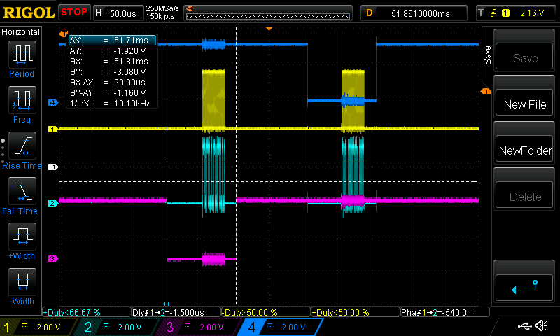

STM32L0 SPI communication with DMA. The SPI CS line is controlled with software. It appears to stay low for about 72uS when the communication only takes about 4uS.
Right before setting the DMA to roll, I set the CS to 0. Nothing else is pending for the DMA. When the DMA RX full interrupt triggers, I set the CS to 1.
Why does the CS take as long as it does? How can I make this time shorter? I would like to do communications more often, if possible.

It seems to take 100uS to transmit and 100uS between transmits (multiple external devices)0693W00000WLLjHQAX.png
Dude
DudeAuthor
December 19, 2022
Goals:
  1. Tighten the time window for a single SPI communication operation, even just to half it to 50uS
  2. Tighten the time window between SPI communications, as much as possible.
I haven't yet found anything to suggest why the communication seems to be blocked or delayed like this. I sense that the DMA might run in blocked time intervals of ~100uS though. Perhaps I can look into its timing to see if that is the case.

Now, if you want to know where the code waste time, use a timer that counts usec as free run and overflow, capture the value at the beginning of the interrupt in a global var, and take a second snapshot at different points to know how long each interrupt segment last. In cortex M3+ there is a debug cycle counter for it that is missing here. In debug modd, put a breakpoint after the second timestamp reading so the interval time can be deducted.
Going step by step in the interrupt, while a bit disruptive, may tell you where most of the time is wasted, and if sequence reorg can be done to improve things.
Dude
DudeAuthor
December 20, 2022
I agree, I can time how long the code in the interrupt takes to execute. However, it seems somewhat independent of the interrupt. When I make the interrupt simply reset or clear the interrupt flag, it still takes a while.
