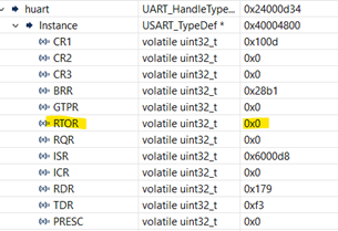

I stepped thru the code of HAL_UARTEx_ReceiveToIdle_DMA:
It seems that CR2.RTOEN and RTOR.RTO are not configured. Nevertheless, I get an DMA done event via HAL_UARTEx_RxEventCallback after data received.
I found a HAL function HAL_UART_EnableReceiverTimeout(). It seems that it is used to specify an idle time, but I'm unsure if this does affect the same idle time used by HAL_UARTEx_ReceiveToIdle_DMA.
