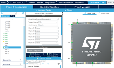

Currently I am working with STM32U575ZIT6 SOC and I am using Timer for counting external clock pulses,
Below is my requirement :
1. I have a requirement to count external pulses using timer for 6 channels, All those channels are connected to spin rate of a physical system; a wind-turbine RPM or something similar.
2. The maximum frequency of the incoming signal To ensure the timer can handle it without missing counts is up to 100 kHz and probably closer to a max of 3600.
3. The counter will roll over and is expected to reset on reboot.
4. Also noticed that a single timer can support only one counting element to count its pulses, Can anyone suggest How I can add a support to count 6 external pulses coming from wind turbines ?

Use 6 different timers in external clock mode and hook up each channel to the ETR signal. The chip has enough of them.
Saket_Om
Hello @ram_jana
You can use external clock mode as suggested by @TDK  or configure the timer in input capture mode.
Please check the example below:
STM32CubeU5/Projects/NUCLEO-U575ZI-Q/Examples/TIM/TIM_InputCapture at main · STMicroelectronics/STM32CubeU5 · GitHub

Hi Saket_Om,
The custom board is already designed, so I can't use the ETR method to connect to a specific pin. Could you please share the firmware using the Input Capture method with Timer 3 and Timer 4?
Hello @ram_jana
I shared the example, you can use it as reference and update it to use TIM3 and TIM4.
