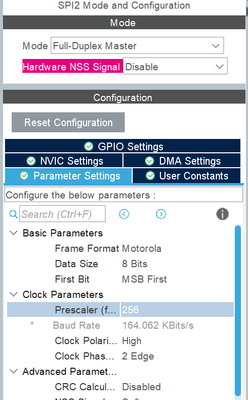

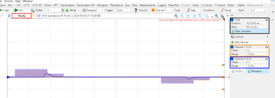

Show the wiring diagram.
Make sure you have a common ground.
Show CLK vs MOSI

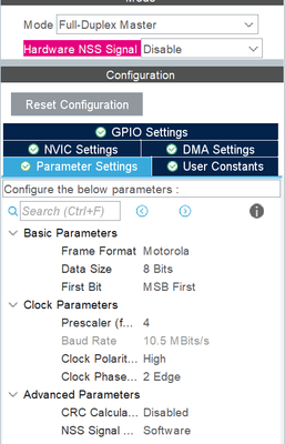

Get the clock rate to 1 MHz rather than 10 MHz

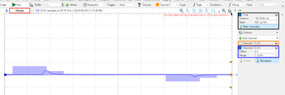

‎2024-09-03 5:21 AM
Orange is SCLK and blue is MOSI.
Best regards.
‎2024-09-03 6:08 AM
This doesn't seem to be correct - there are no pulses on SCK (nor MISO/MOSI).
Double-check the wiring.

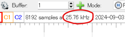

‎2024-09-03 6:08 AM
Not going to catch a 10 MHz signal with a 27 kHz sampling rate.

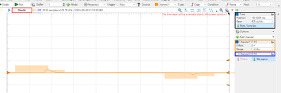

‎2024-09-03 6:52 AM
Your scaling and what you're capturing is unhelpful. You need to capture the interaction of the data/clocks at the point where you're interacting with the WHOAMI register.
Do you work with someone who has more experience debugging digital circuits and signals?
Perhaps start by drawing a schematic of exactly what you've wired to what.
The make/model of boards the TDK IC is mounted on would also be good contextual information in your presentation of the problem.
‎2024-09-03 7:44 AM
Since this module is used for wiring, we assume that the wiring is correct.
Can you tell me what other possibilities there are?
Best regards.
‎2024-09-03 8:54 AM - edited ‎2024-09-03 8:55 AM
Show waveforms on the bus taken by oscilloscope, this time set with proper sampling rate (i.e. at least 4x the SPI baudrate, but more is preferrable).

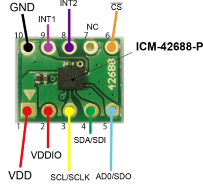

‎2024-09-03 1:24 PM
Looks to be stock imagery, some chance you can share YOUR wiring implementation?
https://strawberry-linux.com/catalog/items?code=42688
There are a lot of opportunities to fail, far fewer to do things correctly and succeed.
VDD + VDDIO to 3.3V
GND to GND
-CS to GPIO
SCLK to SPIx_SCLK
SDO to SPIx_MISO
SDI to SPIx_MOSI
I'd probably avoid HAL_SPI_Transmit() and use HAL_SPI_TransmitReceive() into a scratch buffer, the former is apt to complete early and the CS go high prior to completion.
The signals you want to look at are where it's physically interacting with the part, you'll see the data bits going out, the clocks, and the data bits coming back.
Large traces with nothing happening on them isn't helpful. Are the GPIO pins correctly configured? Can you capture the actual interaction and response? Can you find a Logic Analyzer?
‎2024-09-03 6:14 PM
Thank you for your response.
Changed program to use HAL_SPI_TransmitReceive().

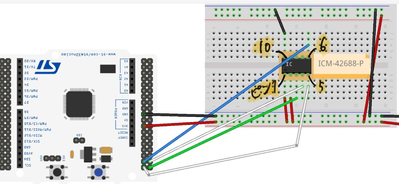

The change to this program returned the value of the WhoAmI() register as 0x0.
Wiring is done referring to this image.
Sorry, I have been disconnecting the module and looking at the signal.
Should I just put the module back on and check the SDI and SDO signals?
Sorry for repeating myself, but thank you in advance.
