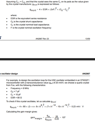

mƎALLEm
Is it the same behavior as the other thread ?
If yes start by reviewing the compatibility of the crystal by referring to the AN2867 and calculating the gain margin:mALLEm_0-1744619426448.png
Do you get the gain margin > 5 based on what do you have in the HW?

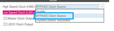

If yes, in that case you need to configure HSE in Bypass mode:
That configures one input GPIO for the crystal oscillator:
after selecting Bypass code is entering Error_Handler() in line
HAL_RCC_OscConfig(&RCC_OscInitStruct) != HAL_OK

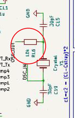

Is it the same crystal and the same project as this thread? if yes why did you accept it as solution? Please clarify this point. Is it the same project?
And this is NOT a cystal oscillator but this is only a crystal.
Did you replace R16 by a solder bridge?

I replaced R16 with 110 ohm resistor.
