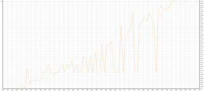

Quite often – perhaps always – some of the temperature readings are being disturbed, but only at certain temperatures. At first, I thought that it was random noise, but in a graph the noise looks strange. Not random at all.
After monitoring the raw ADC values that the DMA has thrown into memory, I discovered something that might be a clue – or it might just be a source of confusion. Every time a noisy sequence occurs, the ADC readout jumps to a lower nearby value where the five least significant bits are all 1, i.e. xxxx xxx1 1111. This is not random noise. It is if as the values are rounded down to nearest 0x001F.
A single spurious readout once in a while can be handled. But when this occurs, it happens so much that the PID regulation is disturbed.
The disturbances are visible in this chart. The orange trace are raw ADC samples, copied directly from the array that the DMA dumps the ADC values in. ADC values are on the right hand axis (decimal). The blue trace is the converted temperature readout, which is where I first noticed the problem.
The disturbing ADC values in this example are 0x073F, 0x07BF, 0x083F and 0x08BF. All ending with the 11111 bit pattern, and exactly 128 ADC counts apart. I have also run tests where the spacing was 64 counts. This also tells me that this isn't random noise.

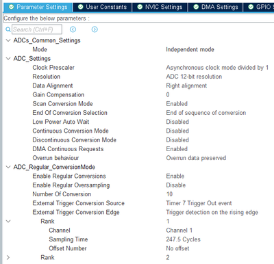

I am unsure about what to show you, regarding setup and code. There is a lot of code in this project. But here is how ADC4 is setup in CubeMX:
Sampling time and offset is the same for all channels.

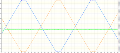

Indeed, the problem was caused by ADCs disturbing each other. And in a particularly nasty way, as the disturbances manifested as SAR bit-decision errors. That is why the patterns were so distinct.
To overcome this, I have completely changed the way the ADCs are triggered. In my main timer interrupt, I've made a sequence, so ADCs 1, 2, 4 and 5, are triggered at specific times, where they never collide.
I couldn't do this with ADC3, as it runs at a much higher sampling frequency. But I moved it to be triggered by update events from a different timer, which runs at a slightly odd frequency, not in sync with the main timer interrupt. In addition, I've set that timer to dither, so the exact sampling time wobbles. I believe this should randomise disturbances even further.
The result is this, which is a stark contrast to the first graph I uploaded:
Thanks to all of you for your assistance! Should any of you find yourselves in Jutland some day, beer is on me!
