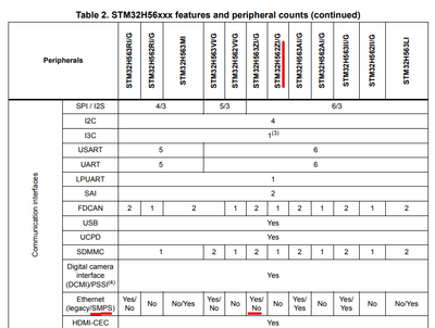

Hi, is anybody able to confirm if the STM32H563ZIT3Q has an ethernet peripheral?
Thanks, regards.

Hello @DPB and welcome to the ST community,
As said by @Andrew Neil you need to refer to the datasheet of the product.
STM32H563ZIT3Q

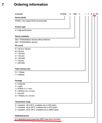

Q means SMPS:
And from this table, its doesn't support Ethernet interface:
You need to use LDO package to have Ethernet.
Hope that answers your question.
