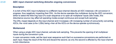

What does the errata sheet say about this? The only section I've found that might be relevant, is this one:
I'm using all five ADCs for different purposes, all using the same clock source, with prescalers set to 1. Perhaps ADC4 is being disturbed by one of the other ADCs. If this is the case, I may be able to make a work-around.
But again, these aren't random disturbances. They only happen in certain windows, hitting very specific values.

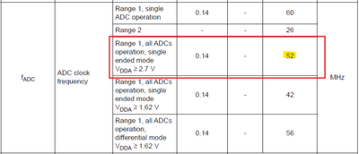

Correct. But 340 MHz / 6 is 56.6667 MHz.
However, you are pointing out something I hadn't noticed before:
When using more than one ADC, 56.6667 MHz is too fast. And I am using all five, all single ended. Thanks @Mikk Leini
Yeeh, the errata sheet is full of ADC stuff. And lots more. If one reads the entire errata sheet before attempting to use the microcontroller, one would seriously doubt that it will even power up.
Now I'll slow down the ADC clock a bit, and see if the issue changes.

Errata sheet of G431:
Interesting, never heard of "bulb sampling".

Good question. The errata sheet dosn't say why it happens, but in my opinion they downplay the problem.
"(...) the worst case (a few LSBs) being when all the ADCs on the device operate synchronously."
A few LSBs??? No, rather big-time SAR bit-decision errors! However, it is possible that the decoupling on my prototypes isn't good enough. On the new version, which I'm about to order, I have improved this greatly.
