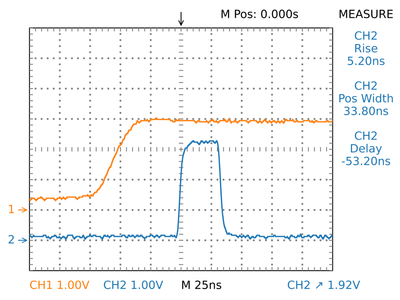

3. exti_exti0_it is the output of the EXTI interrupt controller, the same signal also goes to the CPU's NVIC. The same signal is connected to the DMAMUX controllers, which can use the interrupt's edge to initiate DMAs. But to use these signals to trigger DMA, EXTI's interrupt output to NVIC must also be enabled. This creates a problem: if you don't call LL_EXTI_ClearFlag, the EXTI's IRQ output line remains high, which means the DMA stops after the first rising edge.
So, after each DMA triggering, you either have to also enable an IRQ for the sole purpose of clearing this flag, or you have to clear the EXTI interrupt pending bit by polling, or by another DMA. This is why it's not recommended).
The following oscilloscope trace shows a working example:

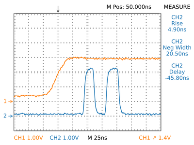

Using the following code:
static void dma_config(void)
	 * Select GPIO bank B as the source of the EXTI input line 0.

	/* Use EXTI line 0's rising edge to generate DMA Request 0 */
	LL_DMAMUX_SetRequestSignalID(
		DMAMUX1, LL_DMAMUX_REQ_GEN_0, LL_DMAMUX1_REQ_GEN_EXTI0
	LL_DMAMUX_SetRequestGenPolarity(
		DMAMUX1, LL_DMAMUX_REQ_GEN_0, LL_DMAMUX_REQ_GEN_POL_RISING
	/* Trigger 4 DMA transfers per request */
	LL_DMAMUX_SetGenRequestNb(DMAMUX1, LL_DMAMUX_REQ_GEN_0, 4);
	LL_DMAMUX_EnableRequestGen(DMAMUX1, LL_DMAMUX_REQ_GEN_0);

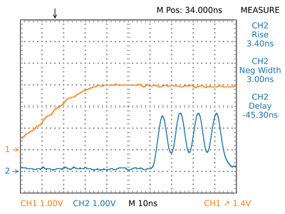

Why should you use DMA1/DMA2 instead of BDMA? The D2 domain can access any memory, the D3 domain can only access SRAM4. Furthermore, the D2 domain's SRAM1 and DMA1 are faster than D3 domain's SRAM4 and BDMA (even though D2 still needs to access D3's GPIO controller). I'm not sure about the exact timing, but from the examples above, BDMA generates a GPIO pulse of 33 ns, but DMA1 generates a GPIO pulse of only 20 ns.
Furthermore, DMA1/DMA2 has a FIFO, which means the DMA doesn't need to access memory for every transfer, it can preload data and write that the destination in a burst. In this process, the DMA also uses the burst transfer type in the AHB protocol, reducing the latency between consecutive words.

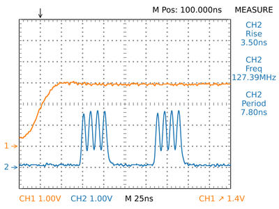

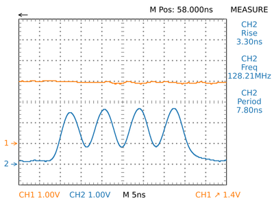

Here's an example of bitbanging GPIO via DMA1 using 8 16-bit burst, generating 8 transitions with a period of 7.8 ns, which is a frequency greater than 120 MHz!  I think this is likely the fastest way to bitbang the GPIO on the STM32H7.
The number of pulses in the pulse train is limited to 4, 8, or 16. Note that time is needed to reload the DMA after each burst, the reloading time depends on the burst settings. In this example, it's 50 ns.
	 * GPIOB Pin 0 would generate a signal on EXTI Line 0.
	LL_SYSCFG_SetEXTISource(LL_SYSCFG_EXTI_PORTB, LL_SYSCFG_EXTI_LINE0);
	/* Use EXTI Line 0 input's rising edge to trigger an IRQ. */
	static LL_EXTI_InitTypeDef exti_ctx = {
		.Line_0_31 = LL_EXTI_LINE_0,
		.Line_32_63 = LL_EXTI_LINE_NONE,
		.Line_64_95 = LL_EXTI_LINE_NONE,
		.LineCommand = ENABLE,
		.Mode = LL_EXTI_MODE_IT,
		.Trigger = LL_EXTI_TRIGGER_RISING,
	LL_EXTI_Init(&exti_ctx);
	LL_AHB1_GRP1_EnableClock(LL_AHB1_GRP1_PERIPH_DMA1);
	__attribute__((section (".sram1_data")))
	static const uint32_t gpio_data[] = {
		0xFFFFFFFF, 0x00000000, 0xFFFFFFFF, 0x00000000
	static LL_DMA_InitTypeDef dma_ctx = {
		.PeriphOrM2MSrcAddress = (uint32_t) &GPIOD->ODR,
		.MemoryOrM2MDstAddress = (uint32_t) &gpio_data,
		.Direction = LL_DMA_DIRECTION_MEMORY_TO_PERIPH,
		.Mode = LL_DMA_MODE_CIRCULAR,
		.PeriphOrM2MSrcIncMode = LL_DMA_PERIPH_NOINCREMENT,
		.MemoryOrM2MDstIncMode = LL_DMA_MEMORY_INCREMENT,
		.PeriphOrM2MSrcDataSize = LL_DMA_PDATAALIGN_WORD,
		.MemoryOrM2MDstDataSize = LL_DMA_MDATAALIGN_WORD,
		.NbData = sizeof(gpio_data) / sizeof(gpio_data[0]),
		.PeriphRequest = LL_DMAMUX1_REQ_GENERATOR0,
		.Priority = LL_DMA_PRIORITY_VERYHIGH,
		.FIFOMode = LL_DMA_FIFOMODE_ENABLE,
		.FIFOThreshold = LL_DMA_FIFOTHRESHOLD_FULL,
		.MemBurst = LL_DMA_MBURST_INC4,
		.PeriphBurst = LL_DMA_PBURST_SINGLE,
		.DoubleBufferMode = LL_DMA_DOUBLEBUFFER_MODE_DISABLE,
		/* don't care */
		.TargetMemInDoubleBufferMode = LL_DMA_CURRENTTARGETMEM0,
	LL_DMA_Init(DMA1, LL_DMA_STREAM_0, &dma_ctx);
	LL_DMA_EnableStream(DMA1, LL_DMA_STREAM_0);
 * Use "noinline" to prevent this function from being inlined to main(),
 * which is in Flash.
__attribute__((section (".itcm_text"), noinline))
static void mainloop(void)
	 * Set GPIO pin A9 as OUTPUT, this is connected to an LED on my devboard
	 * for indicating the firmware status. Can be removed.
	LL_GPIO_SetPinMode(GPIOA, LL_GPIO_PIN_9, LL_GPIO_MODE_OUTPUT);
	LL_GPIO_SetOutputPin(GPIOA, LL_GPIO_PIN_9);
	 * Because DMAMUX is edge-triggered by EXTI's IRQ output, not input, we
	 * must clear the EXTI flag LL_EXTI_ClearFlag_0_31(LL_EXTI_LINE_0); after
	 * every IRQ, otherwise the output flatlines and DMA stops. This can be
	 * done in a real ISR by enabling the IRQ.
     * NVIC_SetPriority(EXTI0_IRQn, 0);
     * NVIC_EnableIRQ(EXTI0_IRQn);
	 * Because we don't want the actual IRQ, NVIC is not enabled on this
	 * signal. But we still need to simulate the IRQ flag clearing
	 * by polling (or potentially another DMA transaction). This convoluted
	 * procedure is the reason that GPIO DMA triggering via EXTI is not
	 * recommended. Use another peripheral such as a timer if possible.
	while (true) {
		 * Use WFI, not polling, because polling itself consumes bus
		 * bandwidth, which makes DMA transfer themselves if we're still
		 * polling during the DMA. If you must use polling, it's better
		 * to pull the NVIC, not the EXTI.
		 *     NVIC_GetPendingIRQ(EXTI0_IRQn)
		 *     // after LL_EXTI_ClearFlag_0_31 + 20 _NOP()
		 *     NVIC_ClearPendingIRQ(EXTI0_IRQn)
		__WFI();
		/* Clear IRQ flags immediately, otherwise DMA stops. */
		 * The STM32H7 has a notorious "spurious IRQ" limitation because
		 * LL_*_ClearFlag() must travel across multiple buses and buffers
		 * with a long delay, causing the IRQ to retrigger. It can be worked
		 * around by clearing the IRQ flag early and relying on the natural
		 * ISR code delay. Adjust this delay if the CPU clock frequency or
		 * emulator performance changes. Always verify with an oscilloscope.
		 * http://efton.sk/STM32/gotcha/g7.html
		for (uint8_t i = 0; i < 20; i++) {
			__NOP();
	LL_DMAMUX_SetGenRequestNb(DMAMUX1, LL_DMAMUX_REQ_GEN_0, 2);
	static const uint16_t gpio_data[] = {
		0xFFFF, 0x0000, 0xFFFF, 0x0000,
		.PeriphOrM2MSrcDataSize = LL_DMA_PDATAALIGN_HALFWORD,
		.MemoryOrM2MDstDataSize = LL_DMA_MDATAALIGN_HALFWORD,
		.MemBurst = LL_DMA_MBURST_INC8,
		.PeriphBurst = LL_DMA_PBURST_INC8,
		/* don't care */
Just make sure gpio_data is located in SRAM 1 (0x30000000) for DMA1, or SRAM 4 (0x38000000) for BDMA, may require custom startup and linker code. How to implement this is out of scope of this thread. I'm using a bare-metal environment, your mileage may vary.
