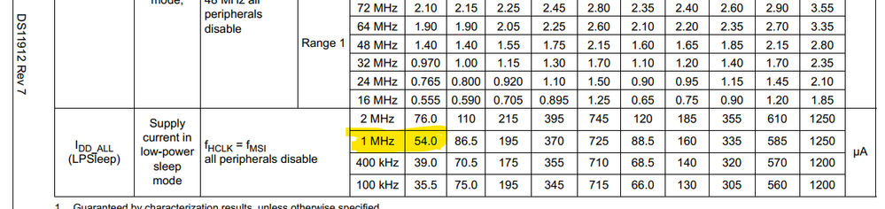

I am working with a NUCLEO_l452RE, temperature 25°C, 1.8V, and I am measuring current on JP6, so I tried to reproduce:
I set up MSI@1Mhz, I got 280uA, much more than 100uA which I was expecting.
Later with MSI@24Mhz, I got 3.24 mA, 135uA/MHz, closer to 100uA.
I disable UART, RCC, LED, disconnect the USB port, and used an external power supply.
There is a bias in current consumption about 180uA? there is something I can do to mitigate it?
On en.fistm324l.pdf I found another number of current consumption, I am very confused about what to expect.

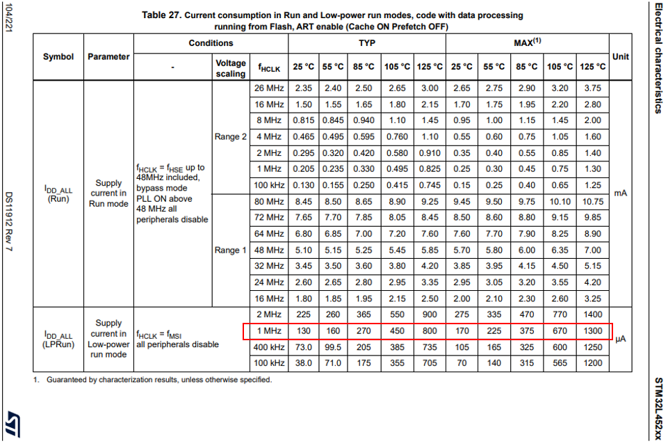

Hello @dhs​,
first of all, I advice to always refer to the datasheet to know the current consumption reference.
for the NUCLEO_L452RE, in LPRun mode at 25°C and MSI = 1MHz, the current consumption should be between 130 and 170 μA.
Are you sure all peripherals are disabled ?

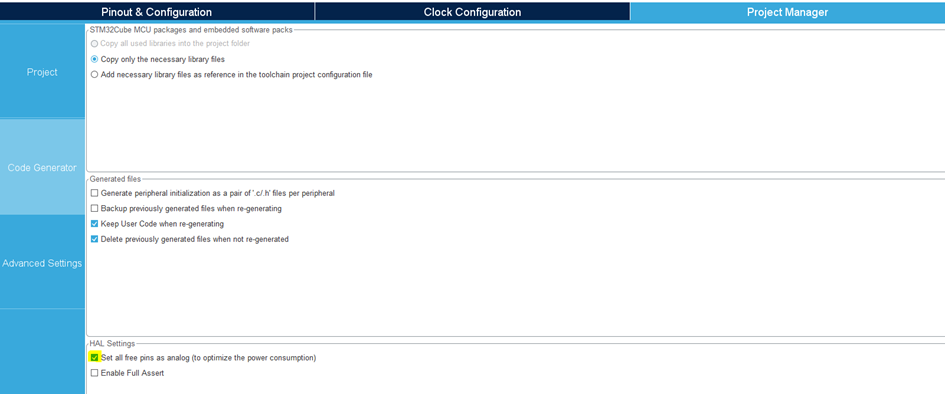

also, it's useful to set all free pins as analog in CubeMX to reduce the power consumption

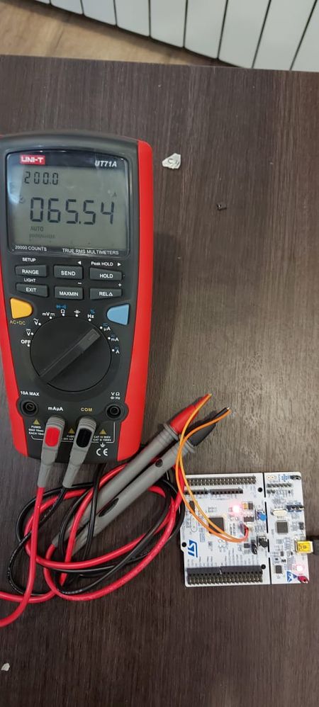

dhsAuthorBest answer
Senior
November 23, 2022
Finally, it started working, I am reading:
  • 65uA MSI @ 1MHz sleep run
  • 130uA MSI @ 1MHZ low-power run
I had a mix of problems
  • My tester connected to JP6, doesn't let the microcontroller reset properly, I had to disconnect and connect again, and later I changed it to one with less impedance.
  • Sometimes I forgot to include HAL_SuspendTick()
I am used to working with msp430, peripherical are more low-power targeted, but stm32l4 is starting to like me very much.
