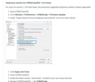

Dear STM32CubeIDE user,
Further to the recent STM32CubeIDE project creation issue, we would like to inform you that a solution is now available for you.
This permanent fix applies to all STM32CubeIDE versions.
  1. Issue description
When creating a new STM32 project in STM32CubeIDE, the “STM32Cube” radio button may have become unresponsive, blocking the “Next” button after the product selection screen. This prevented the project creation from being completed.
  1. Permanent fix
You can apply this resolution to any STM32CubeIDE version, even if you applied the temporary workaround that we recently shared with you.
  1. Open STM32CubeIDE.
  2. Refresh the database.
    Go to Help > STM32Cube updater > Select “Check the Target selector Device Database Updates”
  3. Restart STM32CubeIDE
  4. If you deactivated the auto refresh function previously, you may wish to reactivate it for all your STM32Cube tools. Here is how to proceed:
  • STM32CubeIDE:
    Go to Window > Preferences > STM32Cube > Firmware Updater.
    Select your preferred auto-refresh option.
  • STM32CubeMX:
    Go to Help > Connection & Updates > Updater Settings.
  • STMCUFinder:
    Click on the Settings icon > Settings > Updater Settings.
    In the "Database Auto-Refresh" section, select your auto-refresh option.
We apologize for any inconvenience caused by this temporary issue.
If you require further information or assistance, please contact our customer support.

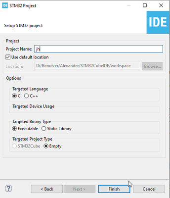

I am using 1.19.
I deleted (as told)
.stm32cufinder, .stm32cubemx, .stm32cubeide and .stmcube
I set the option to "no Auto refresh"
restarted the IDE.
It still does not work. I cannot select an STM32 project. No .ioc
What to do?

As noted in the original post by @Semer CHERNI , this thread is about version 1.18.1 and earlier - so shouldn't affect v1.19.
This is about creating a new project - not sure what you mean about "selecting" a project?
Please give a full description of what, exactly, you are doing - maybe you have a different issue...?
Screenshots may help.
