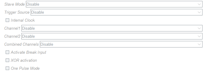

‎2022-01-28 3:47 AM
‎2022-01-28 3:54 AM
1) To handle a fast PWM with high resolution and minimal CPU overhead the Advanced timer is the answer. You could finagle things but why not do this method? Better to mod a prototype board and have circuit best for production.
2) For slower PWMs there are several possibilities, but it really depends on the frequencies and resolution compared to SysClk. A combination of a free running timer with an interrupt, or a system counter, and GPIO interrupts on each iPWM that trigger reading the timer/counter upon each edge (No edges detected in periodic interrupt by clearing the saved counter value after processing)
3) I suggest looking at MOOCS, H7 GPTIM, and
- C:\Users\xxxx\STM32Cube\Repository\STM32Cube_FW_H7_V1.9.0\Projects\NUCLEO-H743ZI\Examples\TIM\TIM_InputCapture
- I put the links for these and more but this forum ate them :(
Paul
