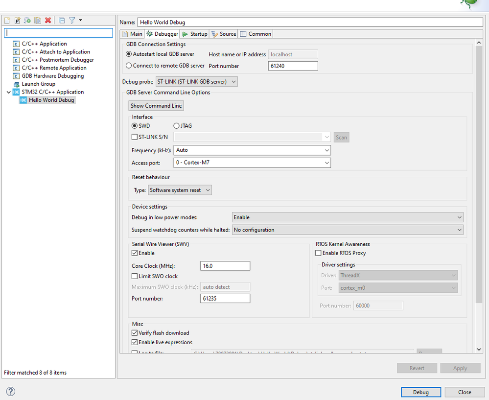

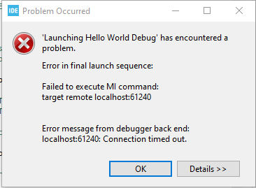

Hi, I have a problem where I cannot debug my code bcs of this error. Anyone know how to solve these problem?
btw im using the STM32H750VBT6x for MCU and ST-LINK V2

This often means that the debugger cannot fit the program into the target memory.
 STM32H750 has only 128 of internal flash. Is your program too big?

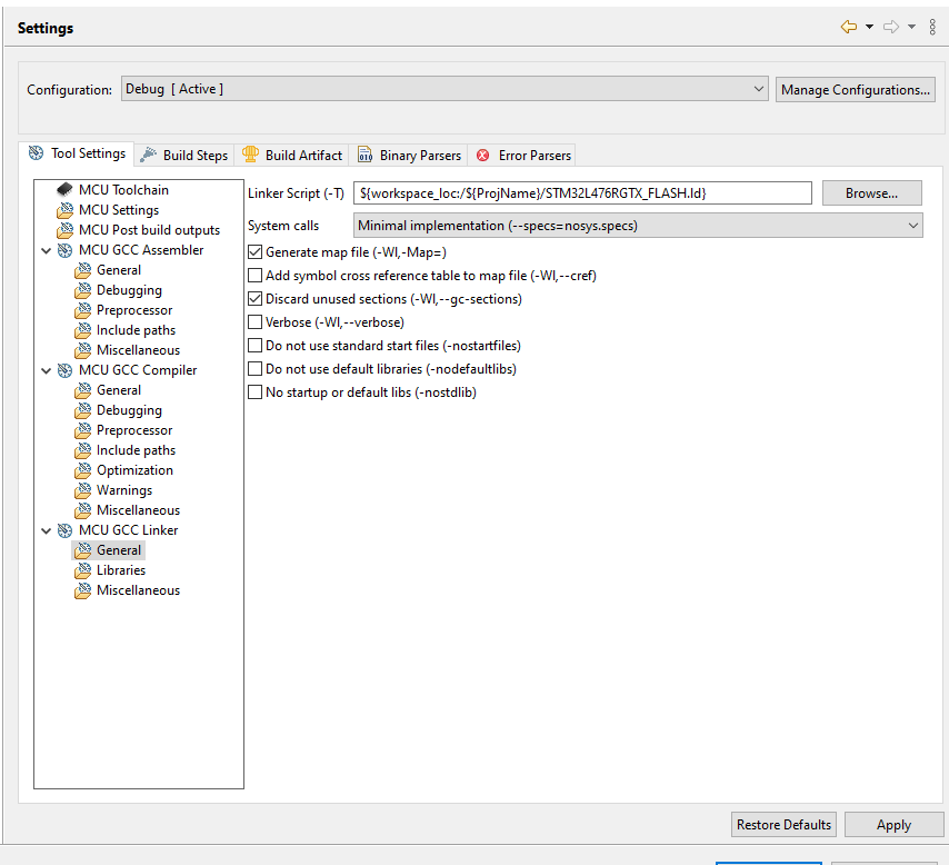

Check the link script, are the memory regions defined correctly? Is the initial stack address correct?
Sorry but where is the link script? You mean the c code? sorry im still new to stm32 environment
The link script is the .ld file. You can find its complete name in Linker settings.
C/C++ build->Settings->Tool settings->MCU GCC linker->General
This is the setting. So, where do i need to change?
I think Pavel was suggesting you review/inspect the .LD file and confirm that the FLASH size was clearly reflected.
This looks more like some connectivity issue with the GDB side and the debugger.

ya i do understand that Pavel ask me to review the .ld file. But I didn't found where is the .ld file. I follow the Pavel instruction to find in the linker setting but that all in linker setting. I have been stuck at this debugger problem almost a week. waste so much time already.
