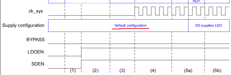

- If I understand the datasheet correctly, the Default Supply configuration (outlined in RM0399 Table 32) should use the LDO Supply configuration (outlined in RM0399 Figure 22 with VDDSMPS connected to GND). Can someone please confirm this understanding is correct?

2- The MCU boots up from the default configuration and power configuration will switch to what user defined in his software in PWR_CR3 register.
If you refer to RM0399 rev 3 / "7.4.1 System supply startup" you find the different power configurations start-up:
- Figure 23. Device startup with VCORE supplied from voltage regulator
- Figure 24. Device startup with VCORE supplied directly from SMPS step-down converter
- Figure 25. Device startup with VCORE supplied in Bypass mode from external regulator
The different steps are described at the beginning of the section 7.4.1.
Each figure shows the "Default configuration" phase and the switch to the user power config phase..
