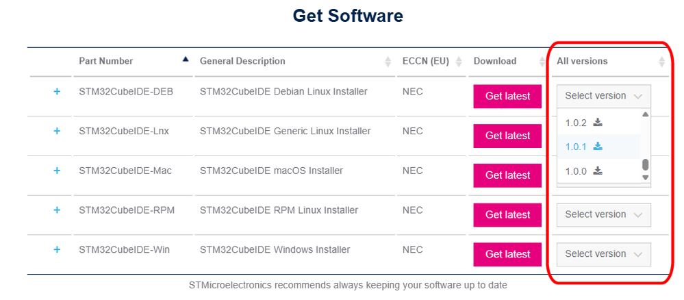

Andrew Neil
Did you just try opening/building the software project? No need to touch the .ioc to do that.
PS:
Note that it is possible to download old versions of CubeIDE - all the way back to 1.0.0
and CubeMX back to 6.2.0
