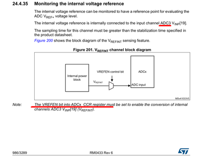

I have encountered a problem trying to work with ADC data on STM32H743 chip. When I read VREFINT value (19th ADC input channel) I always see 0xFFFF. Data on other channels look slightly more adequate (at least they are changed depending on the voltage applied to corresponding inputs). TEMP channel also gives a strange value after recalculations (about 900 degrees). I've got two identical boards and each board gives the same result. The channels are enabled. I tried to read the channels directly in polling mode as well as using DMA, but always got 0xFFFF from VREFINT channel.

VREFINT needs to be switched on in some STM32. Also, it is not available in all ADCs in models with multiple ADC. I don't know how these details are implemented in 'H7, check RM.

Thank you for your attention to the issue. Yes,Vref is enabled. Actually I work with this the same way as I did on a previous board with STM32H743, where it worked without any problems. Moreover, I has just discovered that if I program this project to NUCLEO-H743ZI2 I get proper VREF values (around 0x627E).

Guru
Let's look at the bigger picture.
  • Custom board
  • Other ADC channels also look incorrect, including temperature.
  • Code works on known good hardware.
Magic 8 ball says that your hardware is faulty. Certainly doesn't sound like a VREFINT-specific thing. Perhaps the schematic would shed some light.

Start with checking whether *all* VSS and VDD (including analog) are properly physically connected (think not only errors in design, but also bad solder joints, although with two boards the latter is less likely). Check also VREF+ and if present on your package, VREF- connections.
If VDD is below 2.7V, check also the analog switch booster settings.
