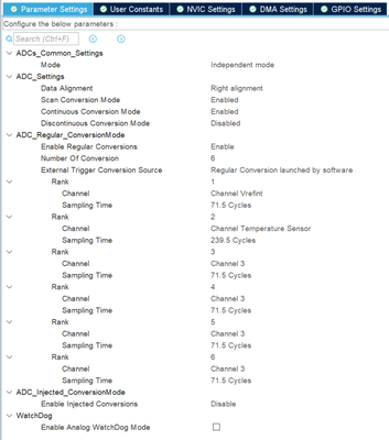

I've been confused for days and am unable to make the ADC work on F103RC and have to seek for help.
The test consists of ADC1 with 6 channels, an UART for printf and an I/O port that drives an LED.
The ADC configuration:
The test code:

static void MX_ADC1_Init(void)
  ADC_ChannelConfTypeDef sConfig = {0};
  hadc1.Instance = ADC1;
  hadc1.Init.ScanConvMode = ADC_SCAN_ENABLE;
  hadc1.Init.ContinuousConvMode = ENABLE;
  hadc1.Init.DiscontinuousConvMode = DISABLE;
  hadc1.Init.ExternalTrigConv = ADC_SOFTWARE_START;
  hadc1.Init.DataAlign = ADC_DATAALIGN_RIGHT;
  hadc1.Init.NbrOfConversion = 6;
  if (HAL_ADC_Init(&hadc1) != HAL_OK)
    Error_Handler();
  sConfig.Channel = ADC_CHANNEL_VREFINT;
  sConfig.Rank = ADC_REGULAR_RANK_1;
  sConfig.SamplingTime = ADC_SAMPLETIME_71CYCLES_5;
  if (HAL_ADC_ConfigChannel(&hadc1, &sConfig) != HAL_OK)
    Error_Handler();
  sConfig.Channel = ADC_CHANNEL_TEMPSENSOR;
  sConfig.Rank = ADC_REGULAR_RANK_2;
  sConfig.SamplingTime = ADC_SAMPLETIME_239CYCLES_5;
    Error_Handler();
  sConfig.Channel = ADC_CHANNEL_3;
  sConfig.Rank = ADC_REGULAR_RANK_3;
    Error_Handler();
  sConfig.Rank = ADC_REGULAR_RANK_4;
    Error_Handler();
  sConfig.Rank = ADC_REGULAR_RANK_5;
    Error_Handler();
  sConfig.Rank = ADC_REGULAR_RANK_6;
    Error_Handler();

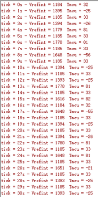

When call HAL_ADC_Start_DMA(&hadc1, (uint32_t *)convertedData, 6), the ADC calls its complete- callback function every second, and gave the following result which I completely don't have any clue:
tick = 0s - Vrefint = 1184 Tmcu = 34
tick = 1s - Vrefint = 1747 Tmcu = -28
tick = 2s - Vrefint = 1745 Tmcu = 81
tick = 3s - Vrefint = 1185 Tmcu = 34
tick = 4s - Vrefint = 1738 Tmcu = -26
tick = 5s - Vrefint = 1639 Tmcu = 81
tick = 6s - Vrefint = 1184 Tmcu = 34
tick = 7s - Vrefint = 1739 Tmcu = -26
tick = 8s - Vrefint = 1638 Tmcu = 81
tick = 9s - Vrefint = 1185 Tmcu = 34
tick = 10s - Vrefint = 1746 Tmcu = -27
tick = 11s - Vrefint = 1598 Tmcu = 81
tick = 12s - Vrefint = 1185 Tmcu = 34
tick = 13s - Vrefint = 1737 Tmcu = -25
tick = 14s - Vrefint = 1636 Tmcu = 81
tick = 15s - Vrefint = 1185 Tmcu = 34
tick = 16s - Vrefint = 1612 Tmcu = -41
tick = 17s - Vrefint = 1590 Tmcu = 81
tick = 18s - Vrefint = 1185 Tmcu = 34
tick = 19s - Vrefint = 1735 Tmcu = -25
tick = 20s - Vrefint = 1598 Tmcu = 81
tick = 21s - Vrefint = 1185 Tmcu = 34
tick = 22s - Vrefint = 1612 Tmcu = -41
tick = 23s - Vrefint = 1590 Tmcu = 81
tick = 24s - Vrefint = 1185 Tmcu = 34
tick = 25s - Vrefint = 1611 Tmcu = -41
tick = 26s - Vrefint = 1639 Tmcu = 81
tick = 27s - Vrefint = 1185 Tmcu = 34
tick = 28s - Vrefint = 1611 Tmcu = -41
tick = 29s - Vrefint = 1597 Tmcu = 81
tick = 30s - Vrefint = 1185 Tmcu = 34
The above result has a fixed pattern:
1. it repeats every 6 seconds
2. in the 6-second data patterns, the results from the 1st second and the 4th second are expected results
Uncomment the code at line 54, the result does not change.
Anyone could let me know anything wrong with my configuration or in my code? And what's happenning in the tests?

In the above given test (the second test), the storage buffer size was indeed not changed to [6], however I just did a new test with the storage buffer size changed to convertedData[6], and got the same result:
It keeps reading out the same 6-second data pattern. the Vrefint should always be read out 1184mv or 1185mv, but I got only 2 correct readings every 6 seconds, why it's 6? what's its relationship with 6 channels?), why the readings are wrong for the other 4 seconds?

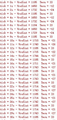

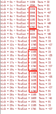

I just increased the number of channels from 6 to 8, and the ADC readings look in the same pattern as in 6-channel test: repeat every 6 seconds:
But when changed the number of channels to 4, the ADC readings seem different:
