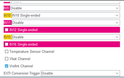

Hello, I am trying to read battery voltage within a task called by sequencer on STM32WB55CEU.
I am following this post: https://community.st.com/t5/stm32-mcus/how-to-use-the-stm32-adc-s-internal-reference-voltage/ta-p/621425

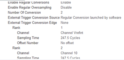

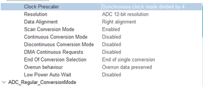

I verified that I can measure both VREFint and Channel 10 separately in Single Mode, however combining 2 measurements in Scan mode does not work. I am not sure whats causing this, considering I am doing everything as recommended in the provided post. It may not be related to BLE. I must be missing something obvious.
In the following code, the call to
	 * Rank 2: measurement channel
	stat = HAL_ADC_PollForConversion(&hadc1, 0xffff);
	uint32_t measurement_raw = HAL_ADC_GetValue(&hadc1);
takes about 10 seconds and measurement_raw becomes same value as vrefint_raw. The Vrefint conversion seems ok.

This is CubeMX config, channel 10 and Vrefint enabled:
Thanks for suggestion, however the error was not related to BLE. I managed to solve this by redefining ADC config in CubeMX, but with no changes, which is quite strange. And also, in scan mode, polling mode, where ADC conversions can timeout, is not completely reliable, better to use DMA. Maybe this is helpful for others.
