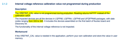

Hello @SZano ,
Could you please take a look at this errata sheet and precisely 2.1.2 Internal voltage reference calibration value not programmed during production errata

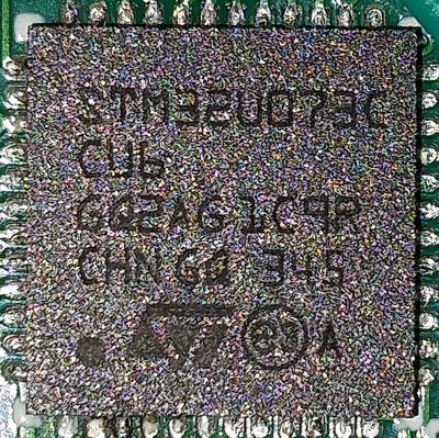

Could you please share a photo of the part marking?

My package is UFQFPN48.
The date seems to be 345, so it must be this errata.
