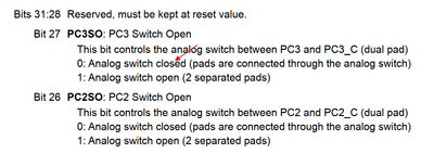

They need to be closed. So their respective values of PCXSO in SYSCFG_PMCR register needs to be 0.
+ Read this article: https://community.st.com/t5/stm32-mcus/faq-default-state-of-stm32h7-switches-connecting-pxy-c-and-pxy/ta-p/49300

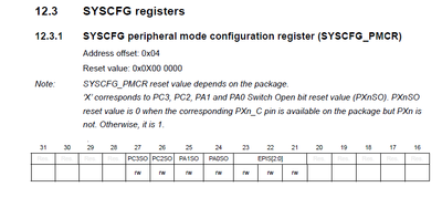

it seems i misled by the H755 user manual.
please check H755 rm0399, page 587
it states 0 is close, actually 1 is close.

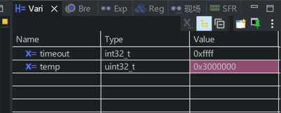

I read PMCR, 0x300 0000, and PC2, PC3 GPIO function is normal now.
0 is default register value from reset, but GPIO is not working.
I think CUBEMX need to generate these switch code if GPIO function is selected.
Peter

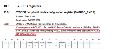

The default status of the switches depends on the package:
Also, read this article: https://community.st.com/t5/stm32-mcus/faq-default-state-of-stm32h7-switches-connecting-pxy-c-and-pxy/ta-p/49300

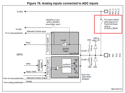

anyway, for H755, these bit has to be set for right GPIO function, however SET means OPEN base on datasheet.
but in HAL, it is CLOSE!
something must be wrong.
Peter
Sorry I did understand the issue.
This API is generic to all H74x/H75x MCUs and the user needs to open/close the switch according to his needs and according to the package he has.

I mean RM0399 user manual should be revised as following:
1: Analog switch closed
0: Analog switch open
do you think so?
