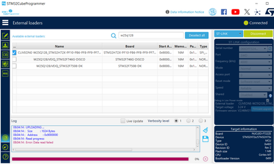

why v2 stlink (stm32h7 series original Nucleo Board ) + cupeProgrammer not connecting with w25q128 flash(external loader) .
external loader not working since from cube ide v18.0.0 has been released and recent version V19.0.0 having cubeMx qspi enable itself .
I was fine with qspi +cube ide v17.0.0 and qspi+cube programmer + CLIVEONE stldr.
Even i have downgraded the cube ide again to v 17.0.0 and below version the same work i carried out for cube programmer as well but nothing worked out .
this is problem of v2 stlink driver or something else ? .
Solved! Go to Solution.

2025-07-23 7:49 PM
Trying to read 0x09000000 not 0x90000000 which is where the QSPI bank is situated.
NINE and 7x ZEROS
2025-07-23 8:15 PM
hi , thanks now works fine .

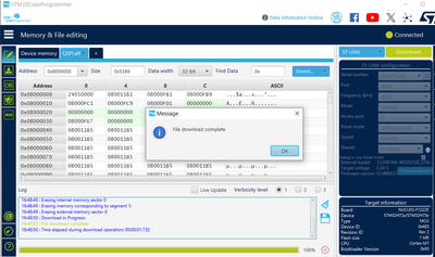

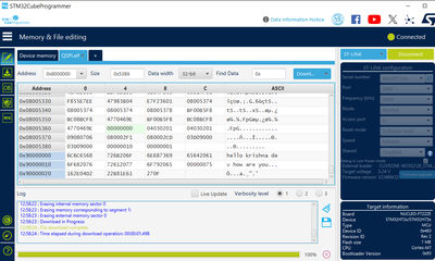

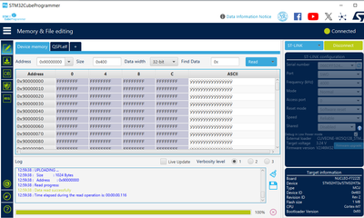

2025-07-26 12:42 AM
My suspect started likewise bellow .
cube mx 6.14.0 will come with cube ide cube ide v1.18.0 (***QSPI problem started***)
cube mx 6.14.1 will come with cube ide cube ide v1.18.1(***QSPI problem Continues***)
cube mx 6.15.0 will come with cube ide cube ide v1.19.0 (*** QSPI completely broken in Cube MX ***)
QSPI problem started from cube v1.18.0 onwards So,I have installed the cube mx 6.13.0 separately and imported further into cube ide v1.19.0 and created elf file tested with following .
QSPI just connect with Programmer via stm32h723zgt6 after QSPI address changes.
i able to write on QSPI Flash (w25q128) visually and it's mapping on proper location.
but nothing was written in flash when i reading Flash memory location .
I am using CLIVEONE stdlr external loader file
2025-07-26 2:57 AM
Show the download pane and verbose log.
The image shows 0x08000000 and then 0x90000000, so it looks like you wrote to internal flash.
2025-07-26 4:30 AM
whole elf file was downloaded via download menu .

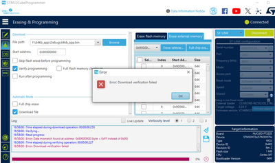

16:54:03:615 : w ap 0 reg 8 R8 0x00000000
16:54:03:615 : w ap 0 reg 9 R9 0x00000000
16:54:03:629 : w ap 0 reg 10 R10 0x00000000
16:54:03:629 : w ap 0 reg 11 R11 0x00000000
16:54:03:629 : w ap 0 reg 12 R12 0x00000000
16:54:03:629 : w ap 0 reg 13 SP 0x00000000
16:54:03:630 : w ap 0 reg 14 LR 0x24000001
16:54:03:630 : w ap 0 reg 15 PC 0x24000965
16:54:03:630 : w ap 0 reg 16 xPSR 0x01000000
16:54:03:630 : w ap 0 reg 17 MSP 0x24001E98
16:54:03:630 : w ap 0 reg 18 PSP 0x00000000
16:54:03:630 : run ap 0
16:54:03:630 : halt ap 0
16:54:03:630 : r ap 0 reg 0 R0 0x00000001
16:54:03:630 : erase: 0211ms
16:54:03:631 : Download in Progress:
16:54:03:632 : Size : 5376 Bytes
16:54:03:632 : Address : 0x90000000
16:54:03:632 : Buffer program...
16:54:03:677 : halt ap 0
16:54:03:677 : w ap 0 reg 15 PC (0x24000000)
16:54:03:677 : w ap 0 reg 17 MSP (0x24000500)
16:54:03:678 : w ap 0 reg 16 xPSR (0x01000000)
16:54:03:685 : w ap 0 @0x24001EC0 : 0x00000200 bytes, Data 0x00000000...
16:54:03:686 : w ap 0 @0x24000000 : 0x00000004 bytes, Data 0x0000BE00...
16:54:03:718 : w ap 0 @0x24000004 : 0x00001A98 bytes, Data 0x4000F080...
16:54:03:718 : Loader write range...
16:54:03:735 : w ap 0 @0x24001EC0 : 0x00000A00 bytes, Data 0x20005000...
16:54:03:736 : W B1 in RAM @0x24001EC0 size 0x00000A00 : 0018ms
16:54:03:736 : Init flashloader...
16:54:03:737 : halt ap 0
16:54:03:737 : w ap 0 reg 0 R0 0x00000001
16:54:03:741 : w ap 0 reg 1 R1 0x00000000
16:54:03:742 : w ap 0 reg 2 R2 0x00000000
16:54:03:742 : w ap 0 reg 3 R3 0x00000000
16:54:03:742 : w ap 0 reg 4 R4 0x00000000
16:54:03:743 : w ap 0 reg 5 R5 0x00000000
16:54:03:745 : w ap 0 reg 6 R6 0x00000000
16:54:03:748 : w ap 0 reg 7 R7 0x00000000
16:54:03:750 : w ap 0 reg 8 R8 0x00000000
16:54:03:756 : w ap 0 reg 9 R9 0x00000000
16:54:03:756 : w ap 0 reg 10 R10 0x00000000
16:54:03:756 : w ap 0 reg 11 R11 0x00000000
16:54:03:756 : w ap 0 reg 12 R12 0x00000000
16:54:03:756 : w ap 0 reg 13 SP 0x00000000
16:54:03:758 : w ap 0 reg 14 LR 0x24000001
16:54:03:765 : w ap 0 reg 15 PC 0x2400080D
16:54:03:767 : w ap 0 reg 16 xPSR 0x01000000
16:54:03:767 : w ap 0 reg 17 MSP 0x24001E98
16:54:03:775 : w ap 0 reg 18 PSP 0x00000000
16:54:03:777 : run ap 0
16:54:03:777 : halt ap 0
16:54:03:777 : r ap 0 reg 0 R0 0x00000001
16:54:03:779 : w ap 0 reg 0 R0 0x90000000
16:54:03:780 : w ap 0 reg 1 R1 0x00000A00
16:54:03:780 : w ap 0 reg 2 R2 0x24001EC0
16:54:03:782 : w ap 0 reg 3 R3 0x00000002
16:54:03:782 : w ap 0 reg 4 R4 0x00000000
16:54:03:782 : w ap 0 reg 5 R5 0x00000000
16:54:03:782 : w ap 0 reg 6 R6 0x00000000
16:54:03:782 : w ap 0 reg 7 R7 0x00000000
16:54:03:784 : w ap 0 reg 8 R8 0x00000000
16:54:03:796 : w ap 0 reg 9 R9 0x00000000
16:54:03:796 : w ap 0 reg 10 R10 0x00000000
16:54:03:796 : w ap 0 reg 11 R11 0x00000000
16:54:03:797 : w ap 0 reg 12 R12 0x00000000
16:54:03:798 : w ap 0 reg 13 SP 0x00000000
16:54:03:799 : w ap 0 reg 14 LR 0x24000001
16:54:03:799 : w ap 0 reg 15 PC 0x24000A65
16:54:03:799 : w ap 0 reg 16 xPSR 0x01000000
16:54:03:799 : w ap 0 reg 17 MSP 0x24001E98
16:54:03:799 : w ap 0 reg 18 PSP 0x00000000
16:54:03:799 : run ap 0
16:54:03:913 : w ap 0 @0x240028C0 : 0x00000B00 bytes, Data 0xE0002301...
16:54:03:913 : W B2 in RAM @0x24010DC0 size 0x00000B00: 0091ms
16:54:03:917 : r ap 0 reg 0 R0 0x00000001
16:54:03:918 : Wait W B1 in Flash @0x90000000 size 0x00000A00: 0000ms
16:54:03:918 : w ap 0 reg 0 R0 0x90000A00
16:54:03:918 : w ap 0 reg 1 R1 0x00000B00
16:54:03:918 : w ap 0 reg 2 R2 0x240028C0
16:54:03:918 : w ap 0 reg 3 R3 0x00000002
16:54:03:919 : w ap 0 reg 4 R4 0x00000000
16:54:03:919 : w ap 0 reg 5 R5 0x00000000
16:54:03:919 : w ap 0 reg 6 R6 0x00000000
16:54:03:919 : w ap 0 reg 7 R7 0x00000000
16:54:03:919 : w ap 0 reg 8 R8 0x00000000
16:54:03:919 : w ap 0 reg 9 R9 0x00000000
16:54:03:919 : w ap 0 reg 10 R10 0x00000000
16:54:03:919 : w ap 0 reg 11 R11 0x00000000
16:54:03:919 : w ap 0 reg 12 R12 0x00000000
16:54:03:919 : w ap 0 reg 13 SP 0x00000000
16:54:03:919 : w ap 0 reg 14 LR 0x24000001
16:54:03:919 : w ap 0 reg 15 PC 0x24000A65
16:54:03:920 : w ap 0 reg 16 xPSR 0x01000000
16:54:03:920 : w ap 0 reg 17 MSP 0x24001E98
16:54:03:920 : w ap 0 reg 18 PSP 0x00000000
16:54:03:921 : run ap 0
16:54:03:925 : r ap 0 reg 0 R0 0x00000001
16:54:03:926 : Write elapsed time: 0134ms
16:54:03:926 : Sector[0] downloaded successfully
16:54:03:927 : File download complete
16:54:03:975 : Time elapsed during download operation: 00:00:00.423
16:54:03:976 : Verifying...
16:54:03:976 : Read progress:
16:54:03:976 : Reading data...
16:54:03:976 : halt ap 0
16:54:03:976 : w ap 0 reg 15 PC (0x24000000)
16:54:03:976 : w ap 0 reg 17 MSP (0x24000500)
16:54:03:976 : w ap 0 reg 16 xPSR (0x01000000)
16:54:03:976 : w ap 0 @0x24001EC0 : 0x00000200 bytes, Data 0x00000000...
16:54:03:976 : w ap 0 @0x24000000 : 0x00000004 bytes, Data 0x0000BE00...
16:54:04:175 : w ap 0 @0x24000004 : 0x00001A98 bytes, Data 0x4000F080...
16:54:04:176 : Loader read...
16:54:04:176 : Init flashloader...
16:54:04:176 : halt ap 0
16:54:04:176 : w ap 0 reg 0 R0 0x00000000
16:54:04:176 : w ap 0 reg 1 R1 0x00000000
16:54:04:176 : w ap 0 reg 2 R2 0x00000000
16:54:04:176 : w ap 0 reg 3 R3 0x00000000
16:54:04:176 : w ap 0 reg 4 R4 0x00000000
16:54:04:176 : w ap 0 reg 5 R5 0x00000000
16:54:04:176 : w ap 0 reg 6 R6 0x00000000
16:54:04:177 : w ap 0 reg 7 R7 0x00000000
16:54:04:177 : w ap 0 reg 8 R8 0x00000000
16:54:04:177 : w ap 0 reg 9 R9 0x00000000
16:54:04:177 : w ap 0 reg 10 R10 0x00000000
16:54:04:177 : w ap 0 reg 11 R11 0x00000000
16:54:04:177 : w ap 0 reg 12 R12 0x00000000
16:54:04:177 : w ap 0 reg 13 SP 0x00000000
16:54:04:177 : w ap 0 reg 14 LR 0x24000001
16:54:04:177 : w ap 0 reg 15 PC 0x2400080D
16:54:04:177 : w ap 0 reg 16 xPSR 0x01000000
16:54:04:177 : w ap 0 reg 17 MSP 0x24001E98
16:54:04:177 : w ap 0 reg 18 PSP 0x00000000
16:54:04:178 : run ap 0
16:54:04:178 : halt ap 0
16:54:04:178 : r ap 0 reg 0 R0 0x00000001
16:54:04:178 : w ap 0 reg 0 R0 0x90000000
16:54:04:178 : w ap 0 reg 1 R1 0x00001500
16:54:04:178 : w ap 0 reg 2 R2 0x24001EC0
16:54:04:178 : w ap 0 reg 3 R3 0x00000000
16:54:04:178 : w ap 0 reg 4 R4 0x00000000
16:54:04:178 : w ap 0 reg 5 R5 0x00000000
16:54:04:178 : w ap 0 reg 6 R6 0x00000000
16:54:04:178 : w ap 0 reg 7 R7 0x00000000
16:54:04:178 : w ap 0 reg 8 R8 0x00000000
16:54:04:178 : w ap 0 reg 9 R9 0x00000000
16:54:04:179 : w ap 0 reg 10 R10 0x00000000
16:54:04:179 : w ap 0 reg 11 R11 0x00000000
16:54:04:179 : w ap 0 reg 12 R12 0x00000000
16:54:04:179 : w ap 0 reg 13 SP 0x00000000
16:54:04:179 : w ap 0 reg 14 LR 0x24000001
16:54:04:179 : w ap 0 reg 15 PC 0x240009F5
16:54:04:179 : w ap 0 reg 16 xPSR 0x01000000
16:54:04:179 : w ap 0 reg 17 MSP 0x24001E98
16:54:04:179 : w ap 0 reg 18 PSP 0x00000000
16:54:04:179 : run ap 0
16:54:04:179 : halt ap 0
16:54:04:179 : r ap 0 reg 0 R0 0x00000001
16:54:04:179 : r ap 0 @0x24001EC0 0x00001500 bytes Data 0xFFFFFFFF
16:54:04:180 : Error: Data mismatch found at address 0x90000000 (byte = 0xFF instead of 0x00)
16:54:04:180 : Time elapsed during verifying operation: 00:00:00.223
16:54:04:180 : Error: Download verification failed
i was trying to download some dummy binary file into external memory via down load menu
