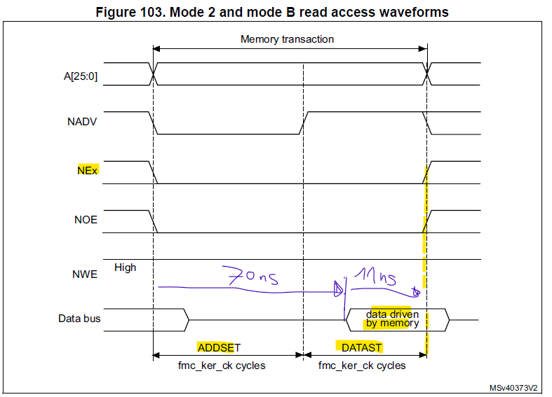

For mode 2B the read timing for H7 FMC in the reference manual RM0433 is specified as
RM0433_figure103.pngAs far as I understand this timing, data is read by the H7 MCU at /NE 0->1 edge.

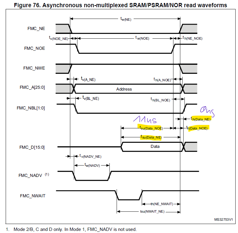

According to the board schematic the EVAL2 RevE is equipped with an NOR FLASH MT28EW128ABA1LPC-0SIT. The datasheet says this device has an access time of 70ns. So data is valid after max. 70ns after /NE 1->0 edge.
According to the H753ii datasheet DS12117 Rev 9 table 163, the H7 has an setup time of min 11ns.
So in my understanding, the entire memory transaction time for a 70ns flash should be calculated as min 70ns+11ns=81ns.
In the demo the FMC is configured to ADDSET+DATAST = 9 + 5 = 14, which calculates to 14*5ns = 70ns.

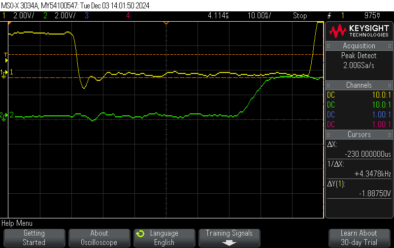

Using a scope, I measure for the memory read transaction (/NE 1->0, 0->1) ~75ns and for /NE low to data valid ca. 60-65ns.
Is my understanding and calculation regarding the FMC NOR flash read timing and parameters correct?
If so, the demo setup does only work for a 60ns flash. Am I right?

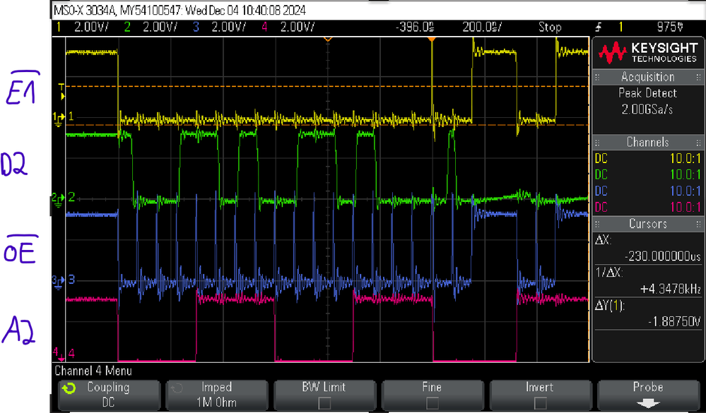

Regarding this scope screenshot here (showing fetch of code which is located in the parallel NOR flash)
the measured cycle time for a sequence of random read accesses is ca. 75ns, assuming each spike of /OE is a 16bit data transfer.
This means the data transfer rate is ca. 2/75e-9 = 26.6 MB/s, this is about 1/4 of the theoretical max. 100MB/s of DQSPI/50MHz/DTR.
I guess this is the main reason why the FFT code execution from parallel flash is 2x slower than from DQSPI.
