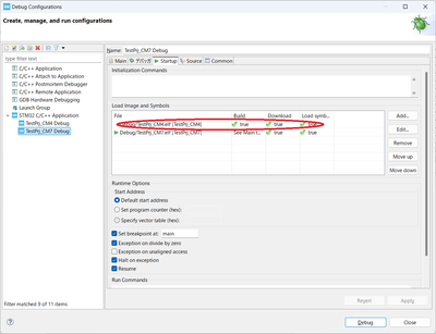

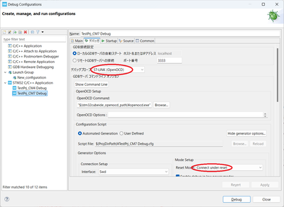

3. Open CM7 Debug Configurations dialog and go to Debugger tab. Set ST-LINK(OpenOCD) to [Debug probe] field, and set Connect under reset to [Reset Mode] field.
4.Go to Startup tab, and add TestPrj _CM4 project, as shown in image below.

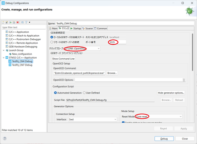

5.Open CM4 Debug Configurations dialog, and set ST-LINK(OpenOCD) to [Debug probe] field, and set "3335" to [Port number] field, and Core reset to [Reset Mode] field.

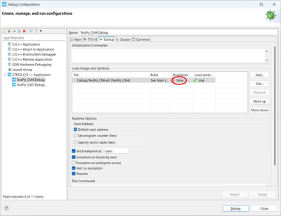

6.Go to Startup tab, and edit TestPrj _CM4 project in which download is false, as shown in image below.

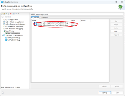

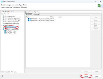

7.Open New_configuration window, and add TestPrj_CM7_Debug and TestPrj_CM4_Debug as shown in image below.
8.Select New_configuration and click Debug button, and uploading is started.

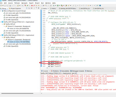

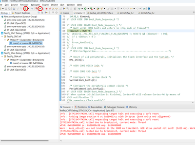

9.After uploading is done, set breakpoint at "MX_GPIO_Init();" line in CM4 main function. That line is positioned below "HAL_GPIO_WritePin (GPIOI, (uint16_t)GPIO_PIN_12, GPIO_PIN_RESET);" line.
10.Click reset button, and click Resume button. But it doesn't break, although LED1 was turned on.

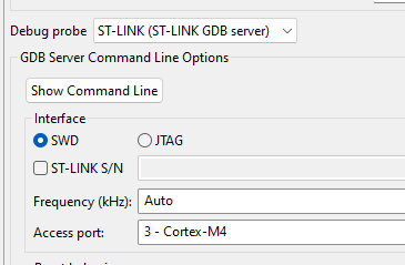

mƎALLEm
Try with STLINK GDB server:
This is what I'm using for your project.
