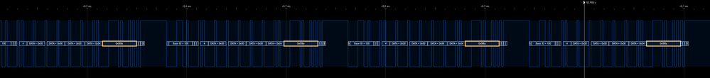

Why do I have random duplicate frames on the CAN bus with a STM32G474?
Context:

I tried to dialog with another STM32G474 (same boards) => Problem, from both MCUs.
with a STM32F7 (so necessary CAN only and not FDCAN) => same results by STM32G4 only.
I have stub CAN bus with a charge 120 Ohms, with only 2 nodes.
I see the random duplicate frames with a logical analyzer and with an oscilloscope.
Tx signals (MCU side) are cleaned. Bus signal is cleaned too.
Example with a duplicate frame five times:
Captured with Ikalogic SP209i and find attached data. You can analyze them with ScanStudio free software tool.
After, the receiver sends another message in reaction. So the message is really received once...
Do you have an idea?

‎2022-04-12 2:49 AM
Hi @Community member​ and everybody,
We have found the mystery!
In fact, regarding the MCU User Manuel (RM0440, Rev.6), Figure 662. CAN subsystem page 1944/2127 and Figure 663. FDCAN block diagram page 1947/2127,
There are 2 clock domains: APB clock and Kernel clock ; and the interface is the Sync block. But never mentioned about the good practices regarding the frequencies, the relation/proportion to have the better synchronization. Can STMicroelectronics share us any informations/details about this Sync block and good practices?
Experience in the field, when I change the APB1 clock division from /16 to /1 (from 3.6MHz to 57.6MHz) and have set FDCAN clock (Kernel clock) from HSE to 24MHz, we do not have duplicate frames!!!
But I do not know how to use it correctly (PLCK1 source? works well with 3.6MHz for 500 bauds (small Quantum Time)?...).
Thanks in advance!
Regards.

‎2024-01-23 12:33 AM
I've had a similar problem with STM32H735VG. With kernel clock set to 80 MHz and APB1 clock set to 36 MHz, there were random duplicit frames on the bus. When I increased APB1 clock to 72 MHz, problem disappeared.
However, in the STM32H735 reference manual RM0468, there is this note on page 2530:
It is written in the context of clock calibration, but it is written in such a way that I suspect it must be valid even when calibration is not used.
To sum up, for STMH735, my understanding is that when kernel clock is set to 80 MHz, APB1 clock must be >= 80 MHz. Just for information if anyone else is debugging that.
